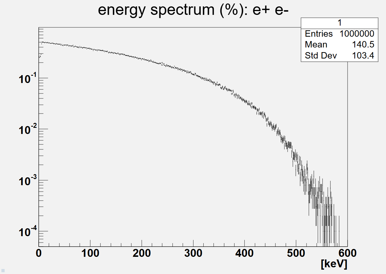

The result of e- spectrum:
The mean energy is 140 keV. According to the NNDC database, the mean energy should be 154keV(NNDC Tb161).

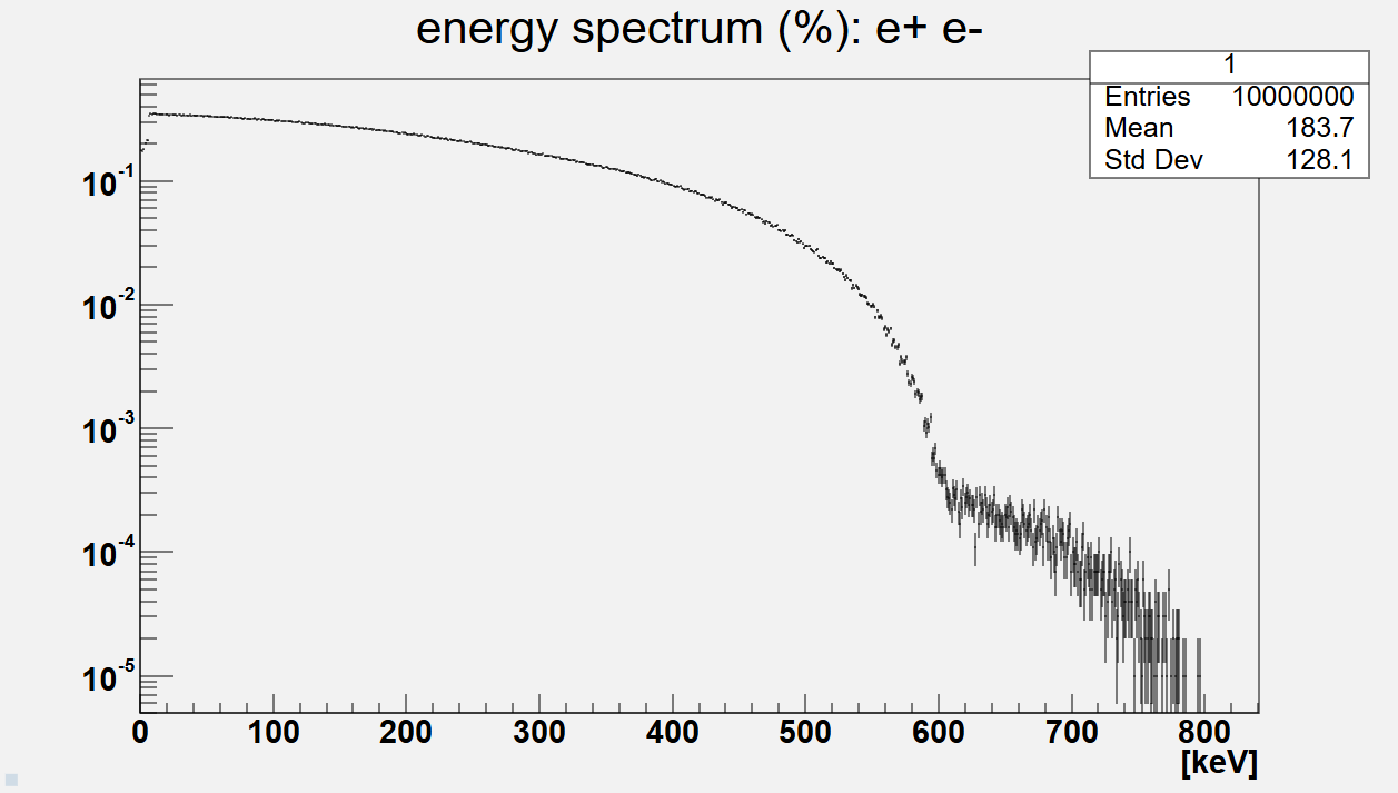

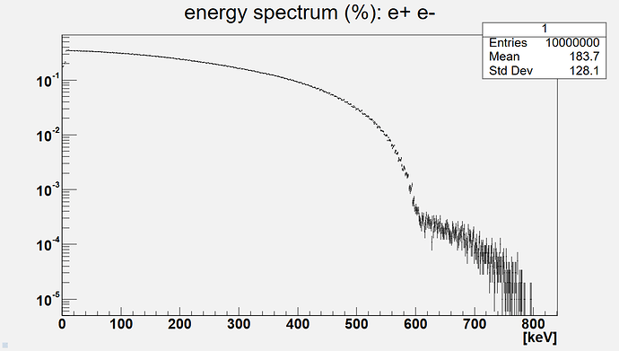

I also tried many other nuclide like I131 which showed a consistent result with NNDC. There is only one discrepancy so far.

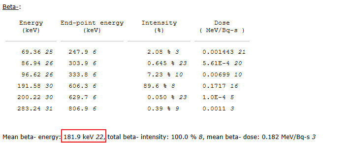

Here I attach the result of I-131 beta spectrum as additional notes which shows a consistent mean energy result.
NNDC I-131
