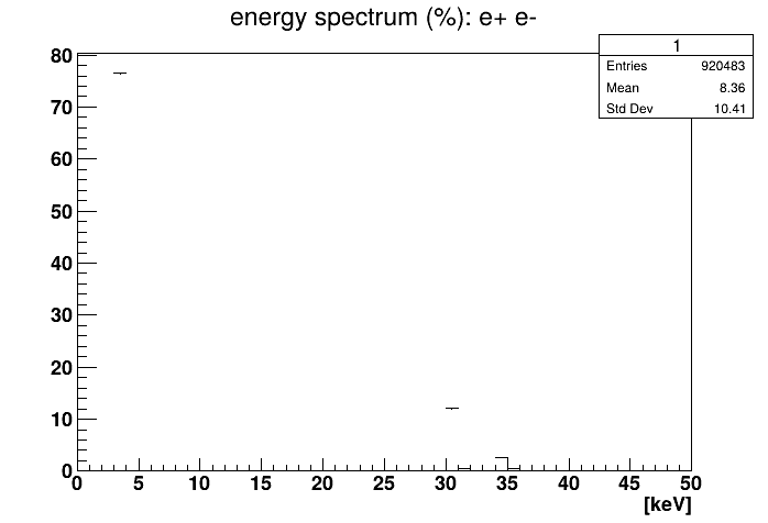

I am trying to simulate Auger electrons from I-125 decay:
https://www.nndc.bnl.gov/nudat3/decaysearchdirect.jsp?nuc=125i&unc=NDS
I used the rdecay01 extended example and modified Co60.mac to generate I-125 nuclei:
/gun/ion 53 125
I modified the binning of the histograms to fit the energy range of the I-125 decay features:
/analysis/h1/set 1  50  0. 50 keV	#e+ e-

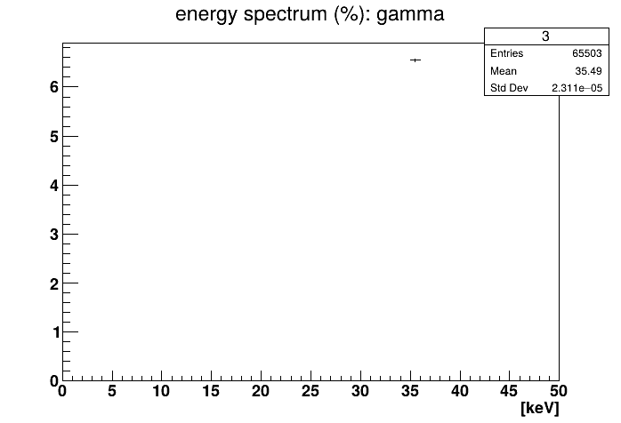

/analysis/h1/set 3  50  0. 50 keV	#gamma
When I look at the energy spectrum of the electrons, I can only see the conversion electrons peaks but not the Auger ones.
Similarly, when I look at the energy spectrum of the gamma-rays, I cannot see the X-rays.
What do I need to do in order to be able to simulate the Auger electrons (and the X-rays) of I-125 decay in the rdecay01 example?

In rdecay01 there is a macro atomicDeexcitation.mac
