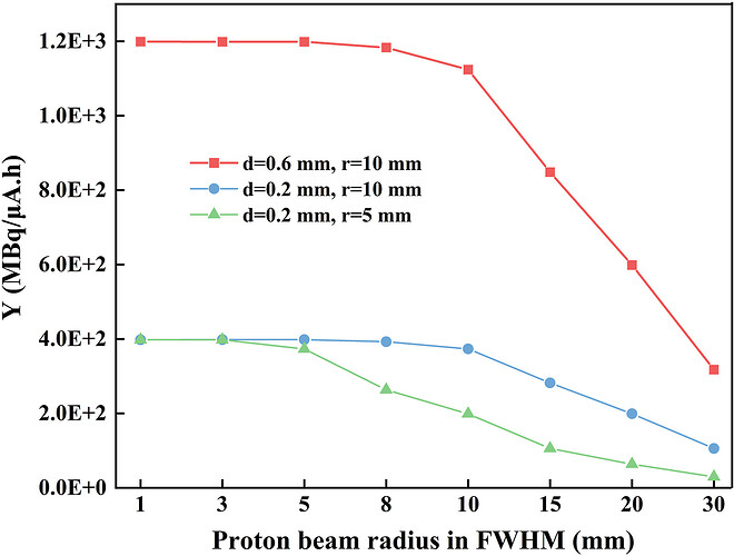

    From my understanding, in the ideal case, for a sufficiently thick, uniform target that stops all protons, the total number of nuclear reactions should not depend on the beam spot size. A smaller beam should simply produce a more concentrated activation distribution, but the total number of reactions should be the same as long as:
    • the beam is fully intercepted by the target,
    • the beam current and irradiation time are unchanged, and
    • proton stopping and nuclear cross sections do not depend on lateral position.
    I had in mind results similar to that found in Figure 4 of (Yu and Chen 2025) https://doi.org/10.1016/j.radphyschem.2025.112695
