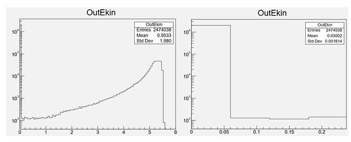

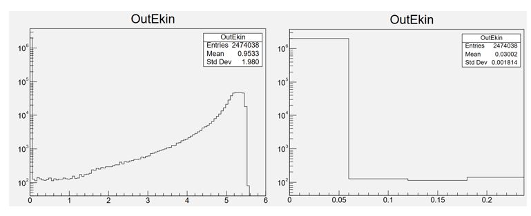

I’m simulating the energy distribution of particles emitted from radioactive decay of an Am-241 volume source and encountering an unexpected issue. At 0.025 MeV, I’m getting 2,000,179 counts, which is significantly higher than my run of 1e6 primary particles. This seems physically unrealistic.

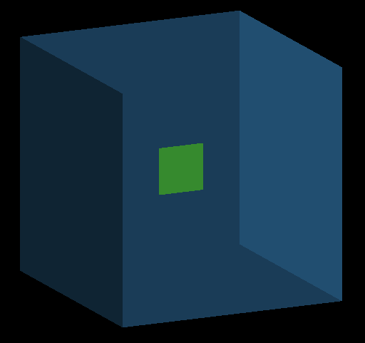

Here’s what the UI looks like:
The blue region—the world volume, defined as air.
The green region—the AmO2 source and the ZnS:Cu scintillator.

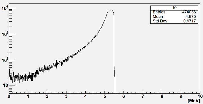

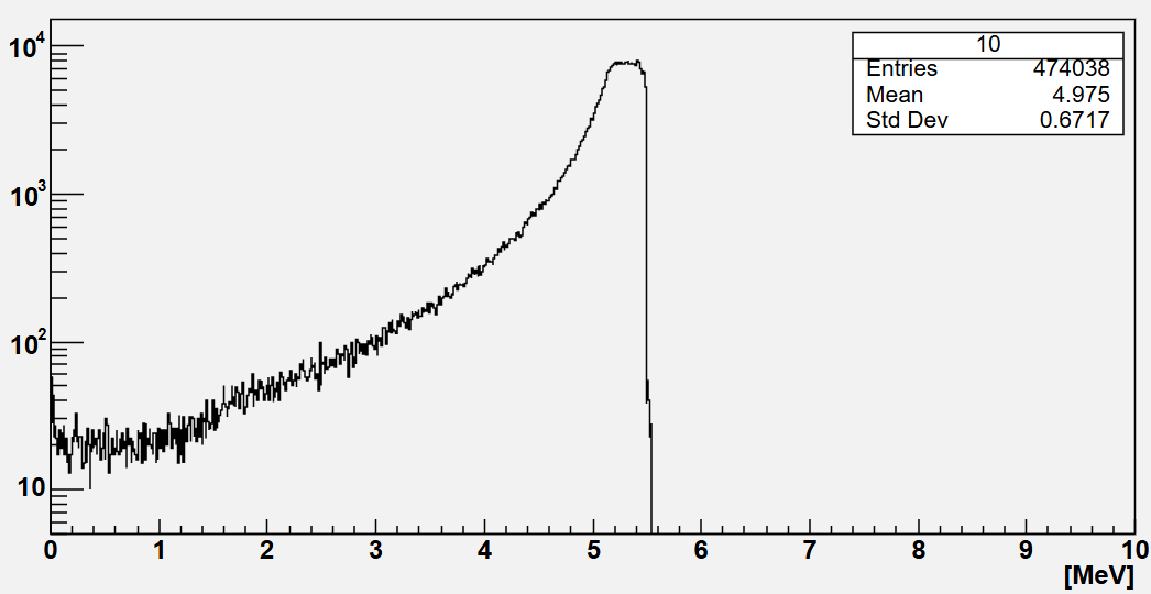

Here’s an update on the issue:
After switching the output from ntuple fills to a histogram (using FillH1() instead of FillNtupleDColumn()), the spectrum looks perfectly normal.
This strongly suggests the problem lies in the ntuple writing step, but I’m still not sure what’s going wrong there.

Interesting…
What do you want your ntuple to look like? Right now, without context, this looks like you are filling the second (“2”) column with your energy values. But you are not also filling out the first (or any other?) column of values at the same time before you add the row?
Is this meant to be a single 1D column of values? If so, you need to get rid of the 2. You might be running into a problem where it doesn’t know what to do with the 2, it becomes a null value that is then histogrammed as 0.
If there are other columns somewhere you will run into an issue where you don’t have values for each column. NTuples are rectangular, not “ragged” arrays. That could also cause 0s to be put in a lot of places to “fill” the space. But I am not sure.
