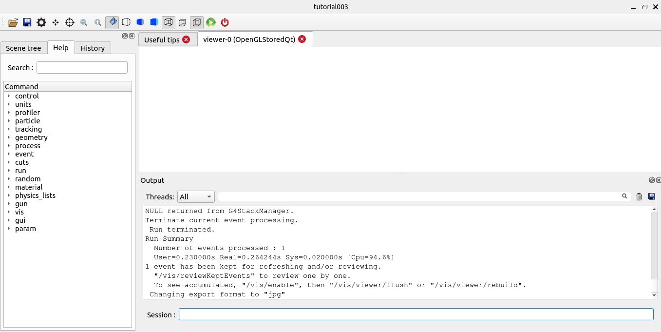

Thanks! I used command:
g++ tutorial003.cpp -Wl,--copy-dt-needed-entries -Wl,--no-as-needed `geant4-config --libs --cflags` -fPIC -o tutorial003
Opened the graphical interface, but the simulation did not appear.

The code compiles if I use the command “./tutorial003 muons.mac”, the interaction is generated and the result is provided in text, it opens the graphical interface, but does not generate the simulation to be viewed and at the end an error message (qt.qpa.wayland: Wayland does not support QWindow::requestActivate() Changing export format to “jpg”) that should be the reason for not being able to view the simulation in the graphical interface.
Track (trackID 2, parentID 1) is processed with stopping code 2
NULL returned from G4StackManager.
Terminate current event processing.
  Run terminated.
Run Summary
   Number of events processed: 1
   User=0.260000s Real=0.399149s Sys=0.030000s [Cpu=72.7%]
1 event has been kept for refreshing and/or reviewing.
   "/vis/reviewKeptEvents" to review one by one.
   To see accumulated, "/vis/enable", then "/vis/viewer/flush" or "/vis/viewer/rebuild".
  Changing export format to "jpg"
As the program is now compiling and running, I’ve moved the post to the Vis category of the forum to see if the experts here can provide some insight.
