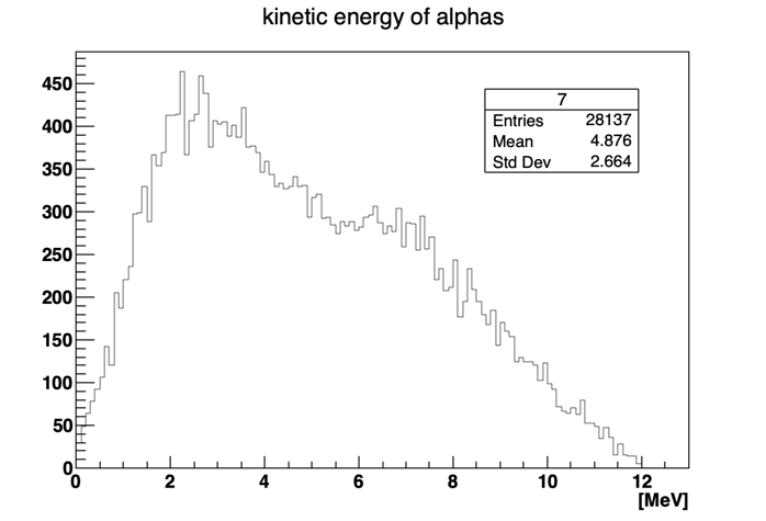

I want to get the flux (energy spectrum) and the angular distribution of the alpha particles using Geant4. I have given the proton spectrum energy as the input in the .mac file. Basically, I need the alpha particles based on proton-boron reaction. p + B = 3 alpha + 8.7 MeV. Is it possible to simulate this in Geant4.
I have tried this. But i could not find any alpha particles being detected. Kindly please help me on this.
Here, a macro for example Hadr03, its printout (with Geant4 11.3), and the energy spectrum of alpha.
kumar.mac.txt (353 Bytes)
kumar.out.txt (2.4 KB)
