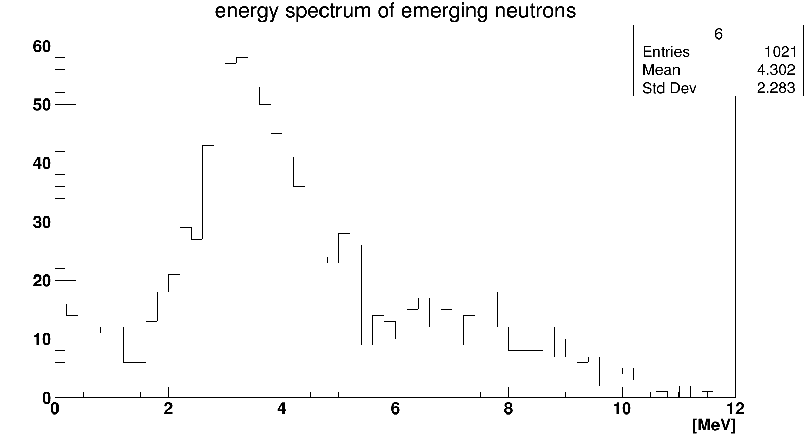

Hi Max!
I was wondering if you could specify how you simulate your source. I’m following as a reference the Geant4 example on /extended/hadronic/NeutronSource and the QGSP_BIC_HP list, but I’m failing to get the spectrum you showed in your picture. This is the spectrum that I get:

Hello Luis,
The spectrum i showed is not the result of a simulation.
It is how the AmBe’s neutron energy spectrum should look like according to ISO 8529.
I attached the spectrum in my own illustration to not infringe copyright and to give people who can’t access ISO 8529 what they are looking for.
