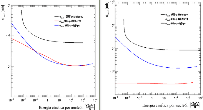

I have a question about how to get inelastic cross sections for antihelium-4. Taking Hadr09 example as a basis, I use anti-alpha particles as a projectile and protons as a target for [1.E-3, 1.E4] (GeV) energy range. In /src/HadronicGenerator.cc i ask for the inelastic cross sections as follows:

Is this correct?, it works well for antideuteron and antihelium-3 cases, but not for 4He-bar because the values are much lower (see attached figure below). I hope you can help me
