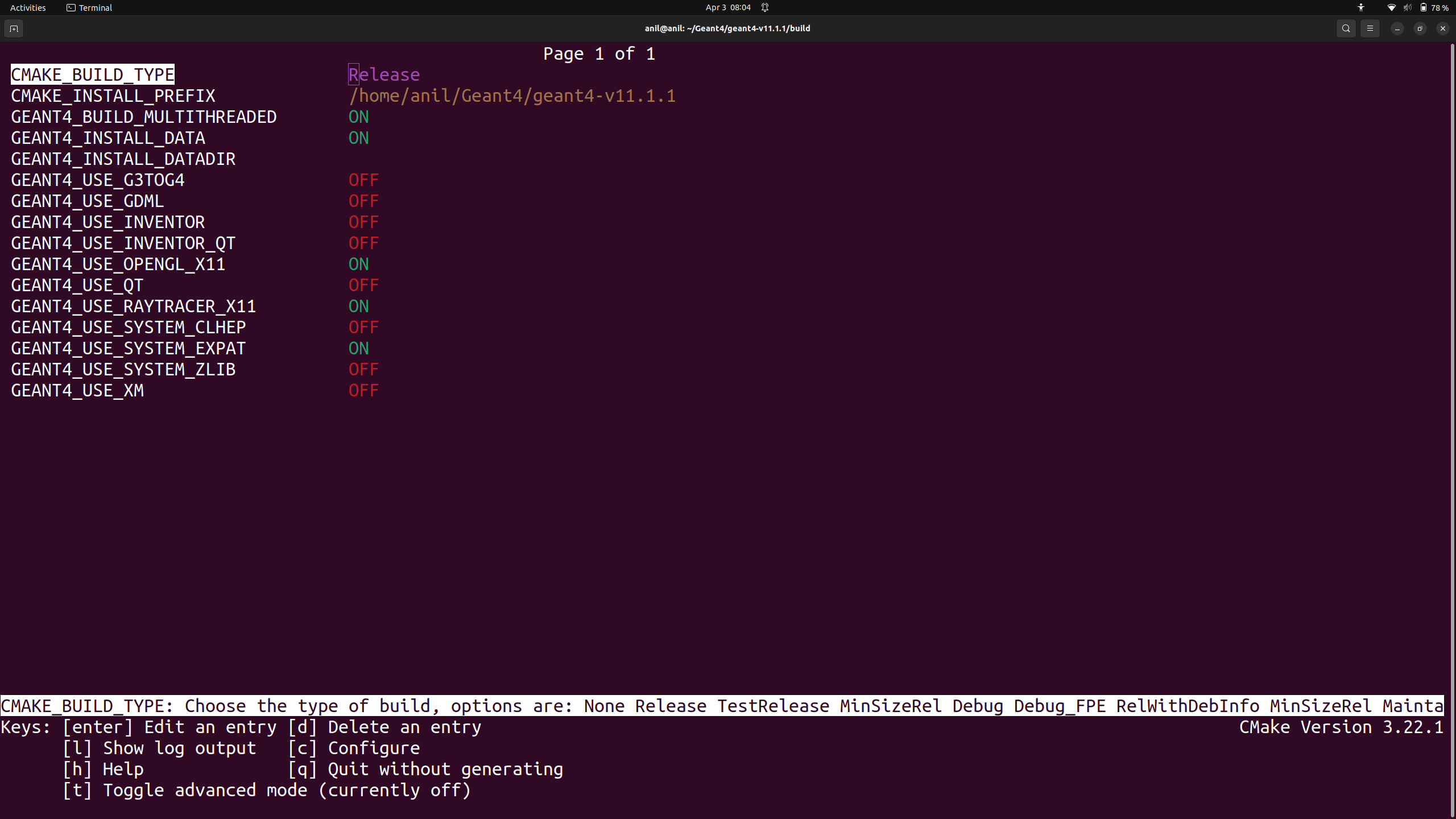

Actually, I also thought that there could be a issue with Qt but then I again built it without Qt and default openGL_X111 =ON. But, I am again getting the same error and hang when I am trying to give this drawVolume command.
I am also wondering that If there is an issue with my buld then how tis exmpleB1 is running so smoothly without any lag?
I tried first with Install_Qt=ON but I thought there’s some issue with QT then I again built it with QT=OFF and default OPENGL_X11 = ON
