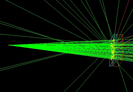

I have searched the forum, but I am still uncertain about the most suitable PhysicsList for this purpose. Below is a simple simulation where a 20 MeV gamma particle is incident on lead (cyan), and I am checking whether secondary neutrons reach the scoring box (red).
When using the commonly recommended “G4HadronPhysicsQGSP_BIC”, no neutrons are produced. However, when I use “GammaNuclearPhysics(“gamma”)”, I can observe neutron production, as shown in the attached image.
Energy, Particle name, Process name
