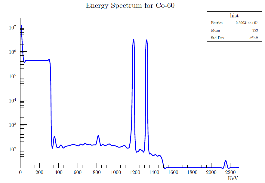

I already used rdecay deant4 applications and I used the /gun/ commands and here below the co-60 spectrum:
and it looks like measured spectrum:
The only difference is the continuum spectrum with deem change in baseline at low energy. The beta decay spectrum should continue not jumping like it is at low energy.
Rachid
I mean the peaks baselines are all flat and different for right peaks and the least energy peak on the left… It seems the baseline level is proportional to the nearby peak., and maybe it depends how rdecay generates the decay products …
Rachid

what you see is the response of the detector to the emitted particles according to the geometry, how energy is recorded and general configuration of the simulation. Could you please make your code public, for example in github?
Best,
Alvaro
How are you obtaining the first spectrum? Are you using energy scorers for a particular detector, or else?
To me, it looks like the detector conditioned in the first spectrum is different to the second, probably scored via G4Step or G4Track. If so, it would explain the practical absence of Compton edge.
