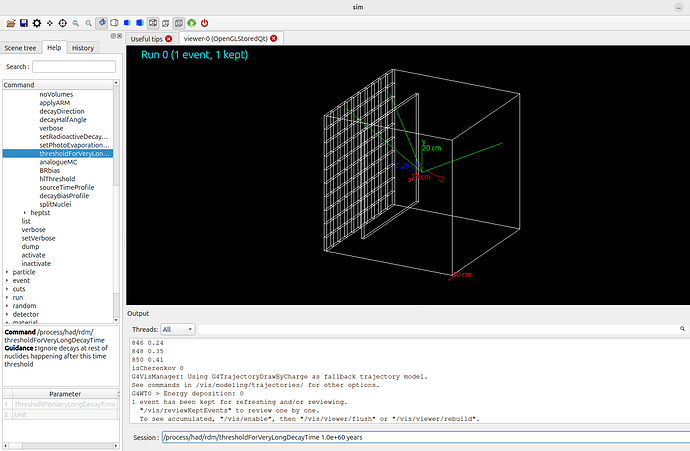

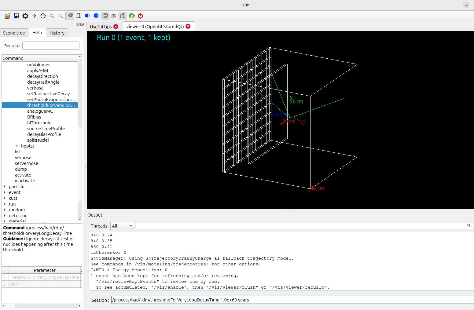

I’m writing a simple Geant4 program that uses a CO60 source as a particle generator.
The program compiles without errors, but when I run it, I don’t get any secondary particles.
Looking at previous posts, I found that I needed to change the thresholdForVeryLongDecayTime variable from 1 year to a very high value.
As recommended, I wanted to change the value in the GUI using the command
/process/had/rdm/thresholdForVeryLongDecayTime
But apparently this command isn’t among the available options.
I use the Geant4 v11.2.2
Does anyone have any ideas?

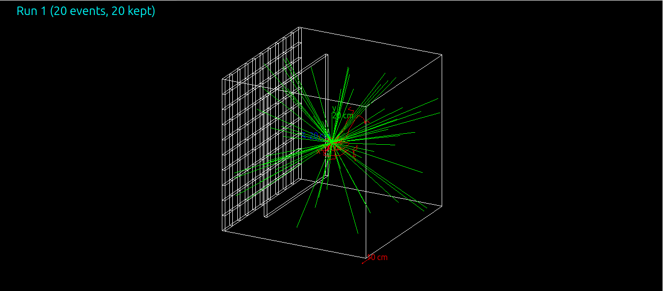

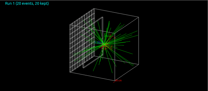

the results.. when set
/process/had/rdm/thresholdForVeryLongDecayTime 1.0e+60 years
and for 20 events
