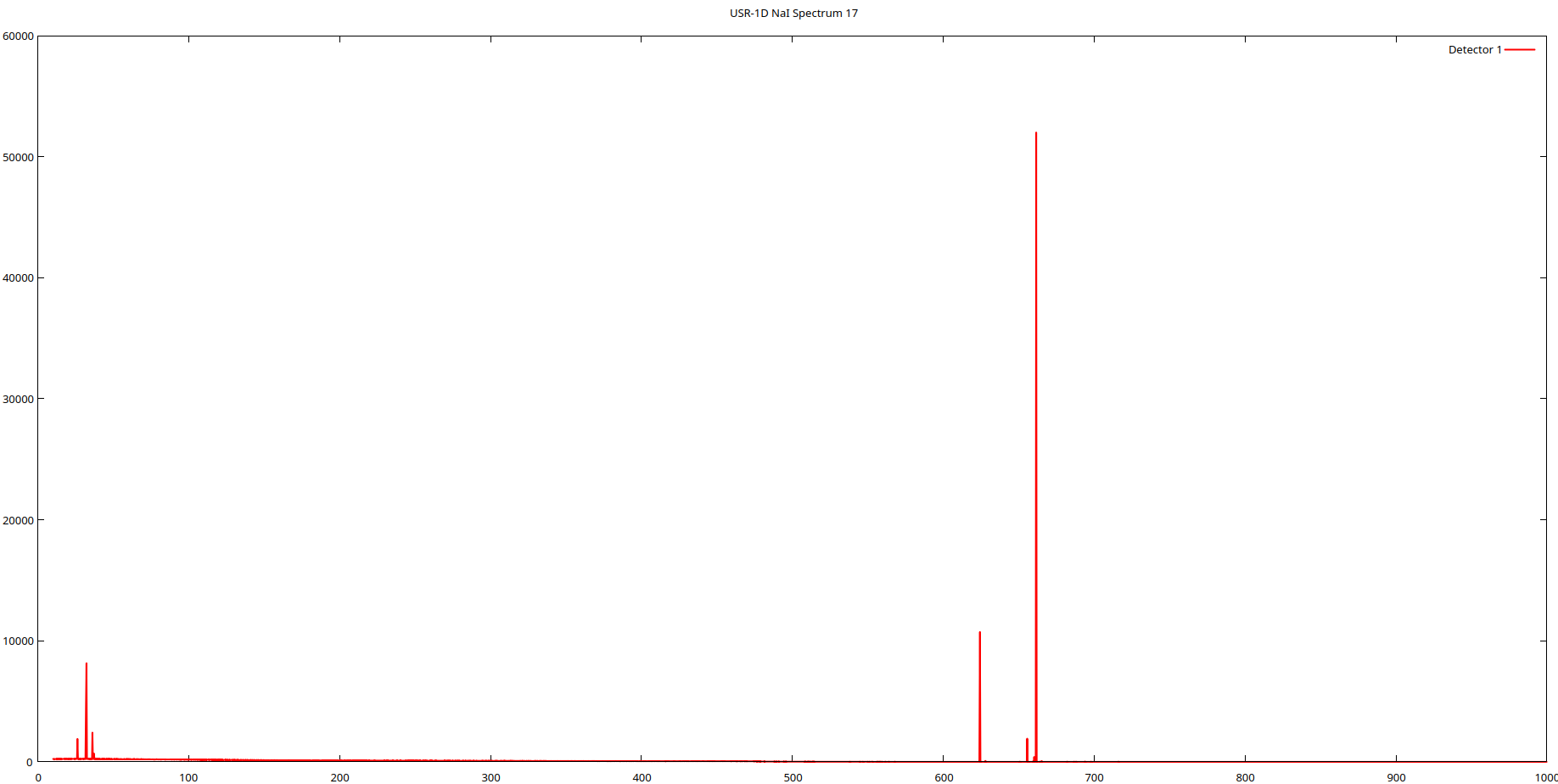

Thank you for your response. The problem is not with energy spectra. The spectra is as expected. There is also 32 keV X-ray peak from Ba-137 emission. However, I have taken 1e7 primaries both in GEANT4 and FLUKA. But for the same number of primaries, there are around 10000 counts in GEANT4 photopeak and 100000 counts in FLUKA spectrum photopeak. I am unable to understand why this mismatch is happening?

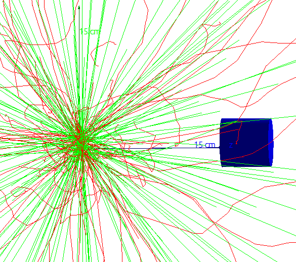

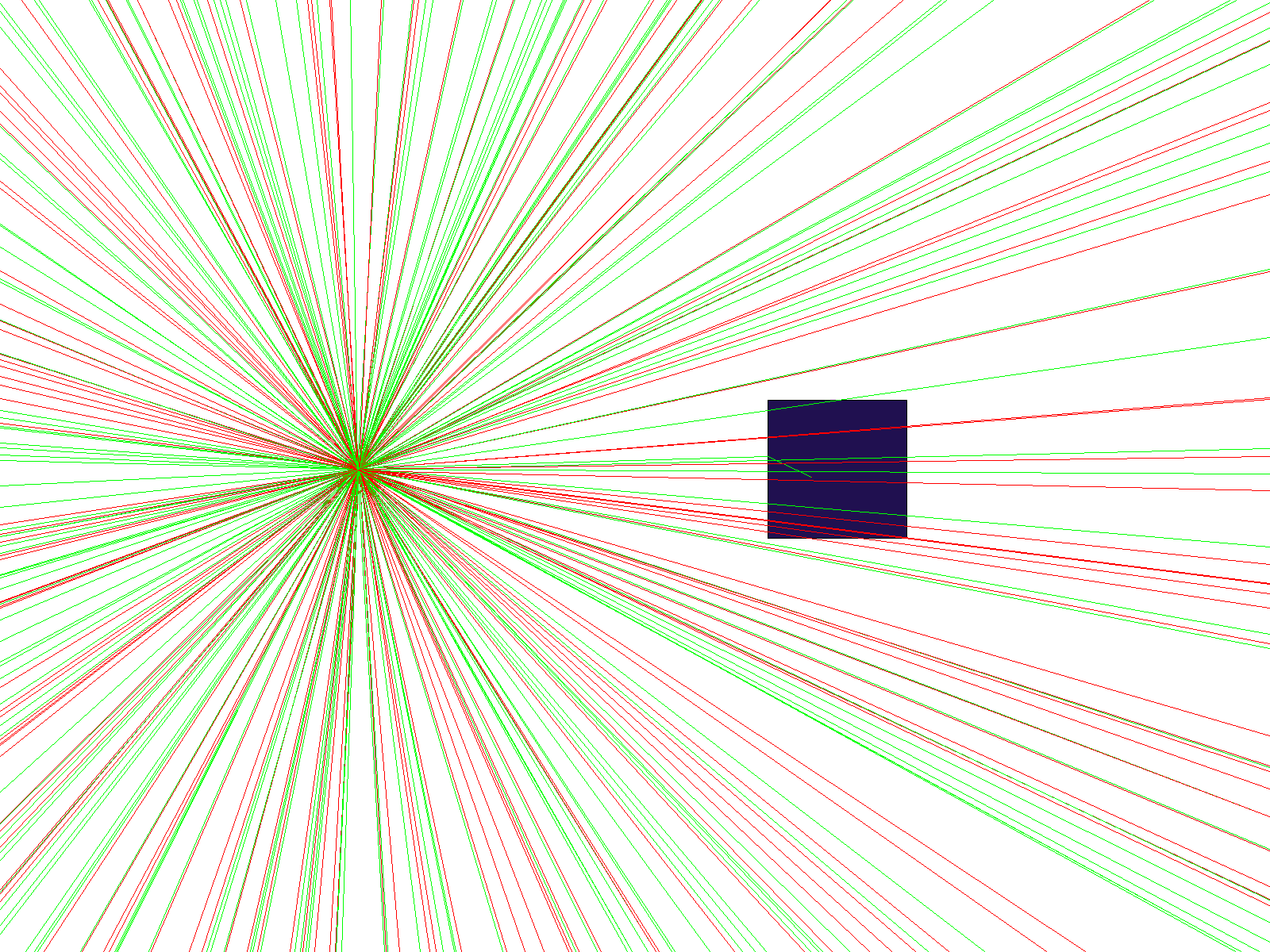

Dear @jrellin I have attached the geometry from both the simulation code. The detector is 2" x 2" NaI(Tl) detector and placed 15 cm away from the source. Number of primaries in both simulations are 15723000. You can see the spectrum difference in the both simulations. It is raw spectrum without gaussian energy broadening. If I also do gaussian broadening the counts become more less in geant4. Please let me know if you need other files also.

It can be challenging to debug someone else’s code when its just 1 simulation, let alone 2. I would suggest trying what I suggested before. Change the particles to a pencil beam of 662 keV photons directed at the dead center of the detector mirrored in both simulations.
That will remove a lot of possible confounding variables.
