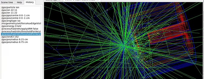

Dear All,
In my program, I also add in the main:
physicsList ->RegisterPhysics (new G4RadioactiveDecayPhysics());//ThV
physicsList ->RegisterPhysics (new G4DecayPhysics());//ThV
physicsList → SetVerboseLevel(1);
physicsList → SetDefaultCutValue(.01*mm);
runManager → SetUserInitialization(physicsList);
but when i asked in the Qt interface for:
/gps/particle ion
/gps/ion 11 22 0 0
/gps centre 0 0 -1 cm
/gps/ang/type iso
/run/beamOn 1000
I get no gamma track issued from the Na22 source
If instead of /gps/particle ion I use /gps/particle gamme I get gamma track

There is at least 1 problem. Unless you specifically say otherwise, geant4 will give GPS particles 1 MeV. Na22 has a half life of 2.6 years and you have to “wait” for it to decay. I’ll go ahead and guess you have vacuum everywhere and so it will happily leave your volume without decaying. This should fix at least that:
/gps/energy 0 keV
The rdecay examples are your friend here especially rdecay02.
Of course I used the syntax /gps/pos/centre 0 0 -1 cm
it works at the condition of typing:
/process/had/rdm/thresholdForVeryLongDecayTime 1.0e+60 year
(it seems that this threshold has been changed between G4 version )
