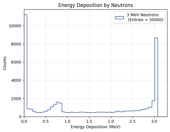

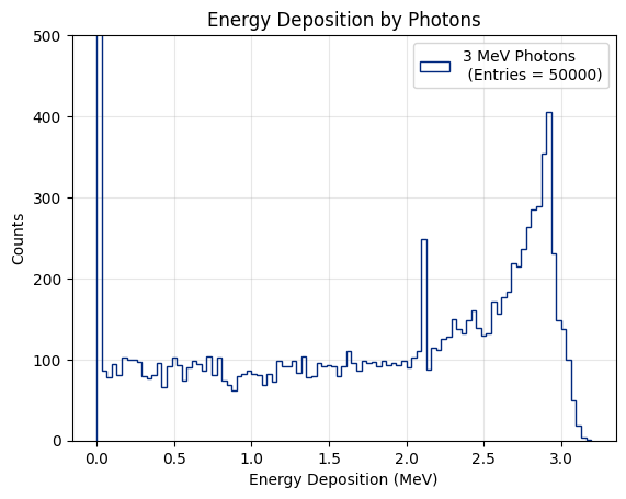

I am currently generating gammas and neutrons and in both cases I have some events with an energy deposition grater than the initial particle genergy. Actually in the gammas case they are very few events (more or less from 0.25% to 0.60%) while for neutrons it depends on the enegry. For 4 MeV neutrons it’s the 15%, for 3 MeV neutrons the 18% and for 2 MeV neutrons 24%. Is it consistent with the physics?
Thanks!!
What do these spectra look like? Doppler broadening can make photopeak events appear to have “more energy” than the initial energy because of the blurring. As for the neutrons, it depends on the composition of your scintillator. The threshold for neutron capture is 0 MeV. So higher energy neutrons might just be escaping more easily. The signature of such captures is… gamma ray peaks or beta spectra from the resulting excited nucleus.
These are the spectra for 3 MeV neutrons and gammas as an example.
You do not say what kind of liquid scintillator you are using. But if it is a typical organic liquid, its constituents are H, C and possibly O. If we consider incident neutron and gamma energies of < 20MeV, prompt neutron capture gamma rays can have energies greater than the incident neutron energy. For instance, neutron capture on 1H yields 2.22MeV gamma rays. Capture on 12C yields a number of gamma rays with a total energy of several MeV (Q-value is 4.95MeV and prominent lines are at 3.68 and 1.26MeV). Neutron capture on 16O behaves similarly to 12C. However, gamma rays in the same energy range cannot deposit more energy than their initial energy.
