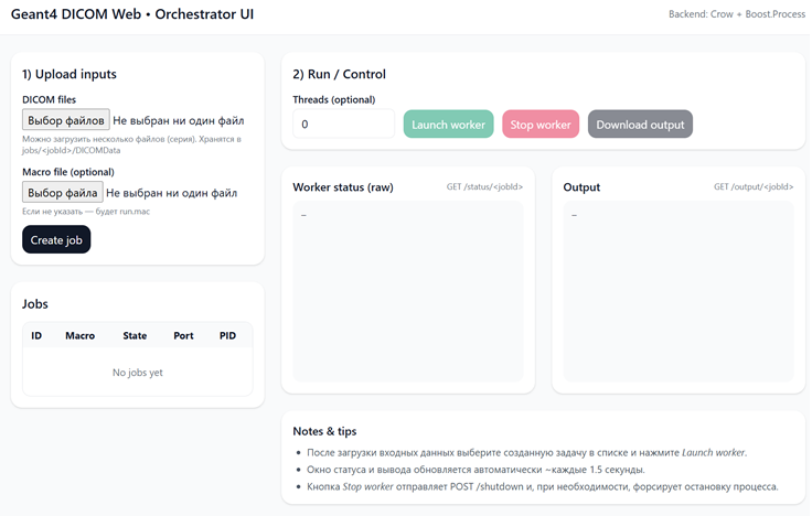

UI (vite/node.js, if NPM exists when configuring CMake, the bundle.js will be recompiled in the INSTALL target, otherwise my bundled js will be used):
