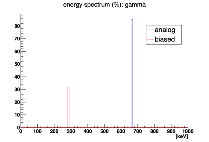

Hello @sslerose , I was able to reproduce the behaviour you describe. Could you please open a bug report in the geant4 bugzilla and add the link to this forum topic?
Thank you.
the effect can be seen with example rdecay01 and the attached macro lerose.mac.txt
It is enough to comment/uncomment the command decayBiasProfile
lerose.mac.txt (454 Bytes)
One can as well play with the existing macro timeWindowBiased.mac
