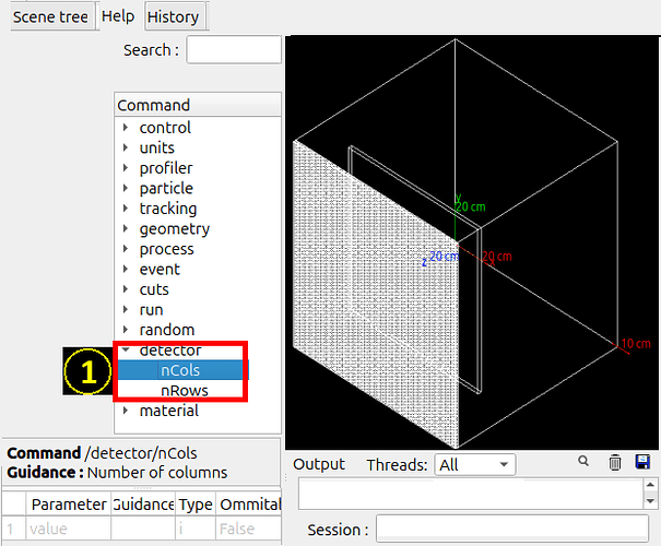

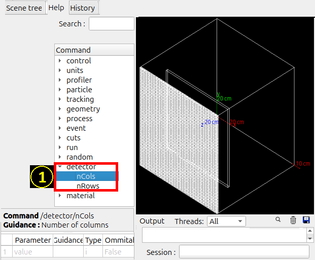

I fixed to 100 the initial number of columns and rows. The compilation and execution is OK
i try to change the number of rows abnd columns from 100x100 to 10x10 using the commands
/detector/nCols 10
/detector/nRows 10
/run/reinitializeGeometry
I check using some G4cout in the construct method that the geometry is redefined…but when i run some event i still have the initial geometry with 100x100 matrix
if some expert can help me !!
The problem is probably because you set nCols and nRows to both be 100 inside the constructor after you call the messenger.
