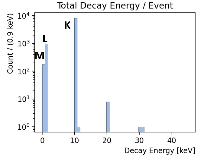

One of our CDMS users is seeing some strange behaviour in Ge-71 decays. The decay process is via electron capture, with three characteristic lines corresponding to K (10.331 keV), L (1 keV), and M (100 eV) capture. However, my collaborator is seeing events with 20, 30, even 40 keV of energy coming from a single Ge-71 decay:

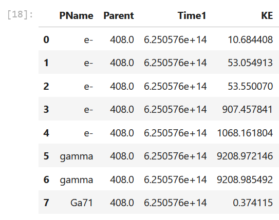

From one of these events, we see a mix of X-rays (G4Gamma) and Auger electrons, which clearly have some double dipping going on (the screenshot is a Pandas dataframe from Jupyter; sorry):
The two “gammas” have close, but not identical energy, so this isn’t a “reading the ROOT file” problem. There are other events where instead of explicit X-rays, there are multiple collections of Auger electrons which sum up “too much” as well.

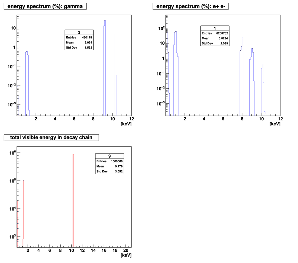

Here a macro for example rdecay01, its printout and the plots.
( do not forget to set ARM = true in PhysicsList::ConstructProcess() )
Among 10ˆ6 events, I do not see any event with energy excess.
atomicDeexcitation.mac.txt (510 Bytes)
atomicDeexcitation.out.txt (1.9 KB)
I agree with your direct-decay results, Michel. We ran jobs with single Ge-71 decays, as well as neutron captures embedded in a germanium volume, and did not see any duplicates.
Out of 20 million neutron capture events in our experimental geometry (a Cf-252 source outside a six-stage cryostat), we saw two events with “duplications.” We are continuing to investigate in detail, and I will follow up here.
