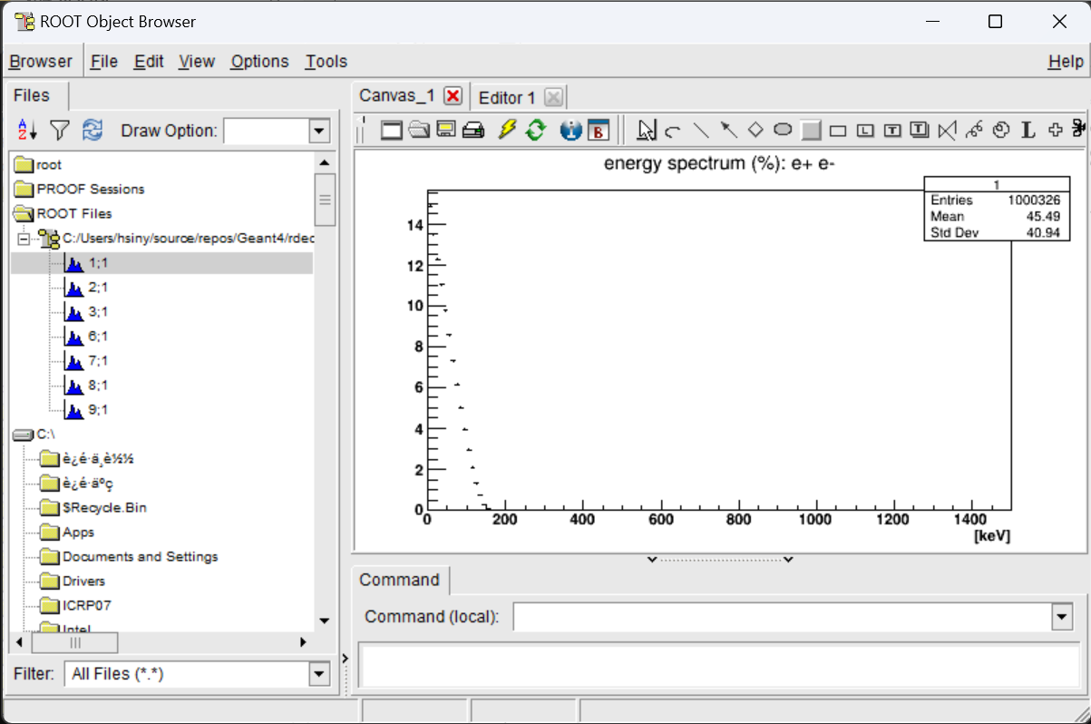

The maximum electron energy of beta decay of Co-60 with the maximum branch ratio is 160 keV in both Windows and Linux, and the correct energy should be about 317 keV. I’m sorry that as a new user I can’t post more than one picture. I will upload my pictures below.
I’m cautiously guessing that this is an issue with the new version of Geant4 and not my personal problem, as I have produced this issue both on Windows and with G4VM (https://geant4.lp2ib.in2p3.fr/), And I have never seen this problem on older versions.
Could anyone please take the time to try to reproduce this issue?
This is the electron energy spectrum of Co60 in the “rdecay01” example in Windows:
This is the electron energy spectrum of Co60 in the “rdecay01” example in Linux:

I suspect this problem may not exist only with rdecay01, but with G4RadioactiveDecay. I first discovered this problem in an example I wrote myself, and the reason why I use rdecay01 example in this post is just to make it easier for everyone to reproduce.
