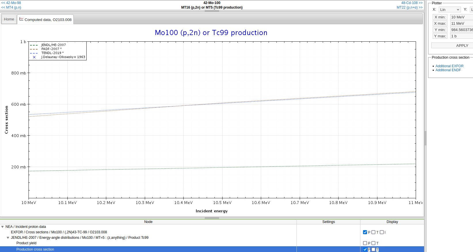

I work on Mo100(p, x)Y nuclear reaction modeling. The Molybdenum100 (92.2% enrichment) target was irradiated by protons with kinetic energies about 10.79 MeV. On the screenshot attached it’s seen that Mo100(p, 2n)Tc99m reaction has higher cross-section than Mo100(p, n)Tc100. However, after bombardment of the target with 10E07 protons I got the following results:
  1. The production of Tc99m: “Tc99[142.683]”: 51
  2. The production of Tc100: “Tc100”: 5707
Both nuclei have protonInelastic creator process.
How is it possible?
