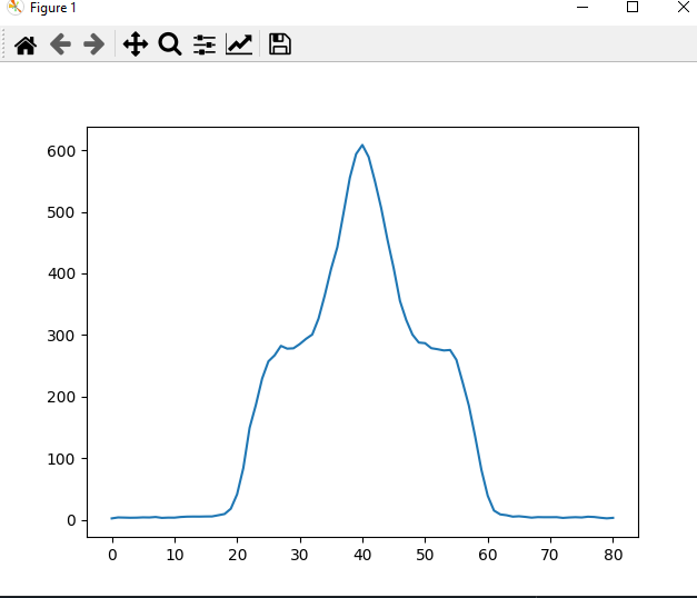

Dear Sir,
I did the simulation as you said, but the result doesn’t seem to be as expected, it shows an abnormal peak when I aggregate the results. I also attached another result with the PHITS code. Can you help me check why?
Figure 1. Geant4 results

Figure 4. PHITS results with 1E10 histories
