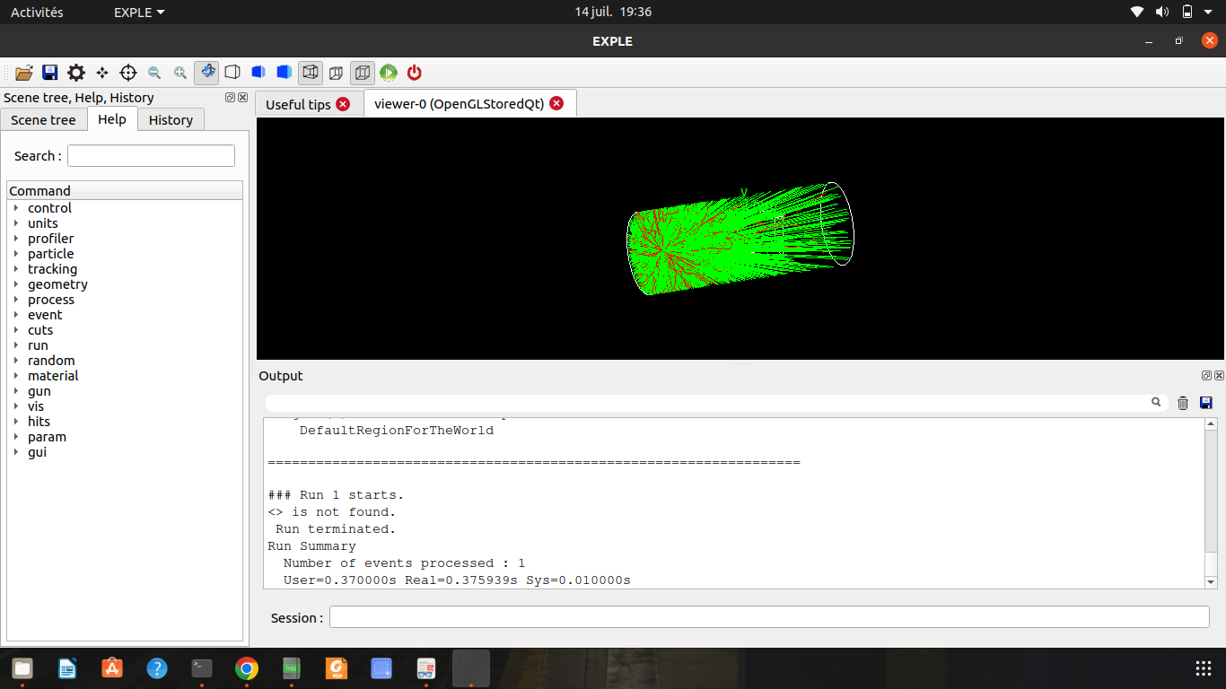

hello, my code below does not display my hits on the screen, so I do not know where the problem comes from and the message saying that “is not found”, I do not understand it.
Thank you, cordially Raoul

to print tracks you can add in your macro
/tracking/verbose 1
VRS
ok, thank you very much, it works
