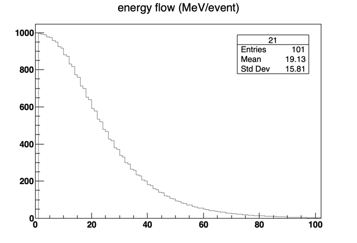

In SteppingAction, and Run.cc, we compute the energy flow per plane (histo 21).
It is up to you to see what you can learn from this code.
