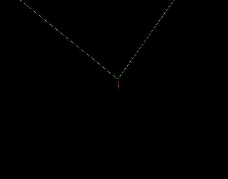

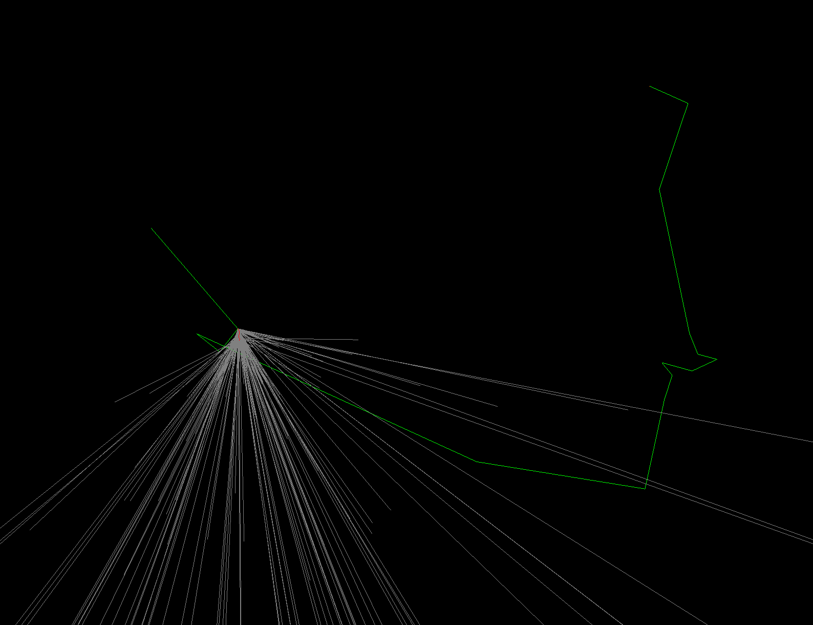

Thanks @mkelsey, so my electron has a production cut of 1m, so it shouldn’t be this I assume. I show an example event to illustrate the problem (gamma = green, electron=red, opticalphotons=grey)
What is your material? A production cut of 1 m is almost certainly killing nearly all your secondary electrons before they ever get tracked.
If you reduce your electron production cut to 10 cm, what do you see? 1 cm?
@mkelsey water is the material. Ahhh I see, smaller is better! I moved the cut down to micrometer scale and they appear now! Thanks so much @mkelsey! :slight_smile:

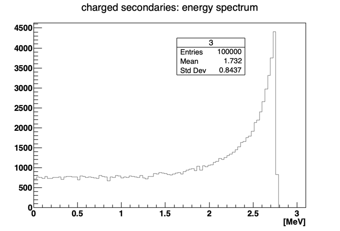

Below, a macro for example TestEm14, its printout, and the plot of e- spectrum.
It shows that Compton scattering works as expected, even with a cut of 1 meter.
There is an option (/process/em/applyCuts) to generalize production threshold to all electromagnetic processes. This option is not by default, and you should have a strong reason to use it.
