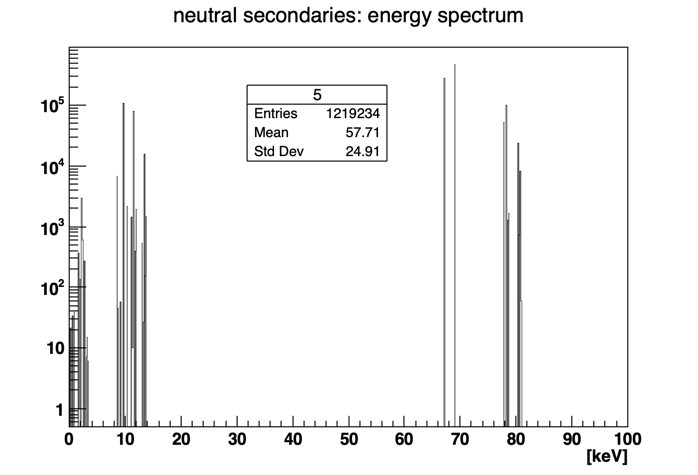

Below, a macro for example TestEm14 (inspired from atominDeexcitation.mac) and the histogram of photons from atomic deexcitation.
adam.mac.txt (915 Bytes)
