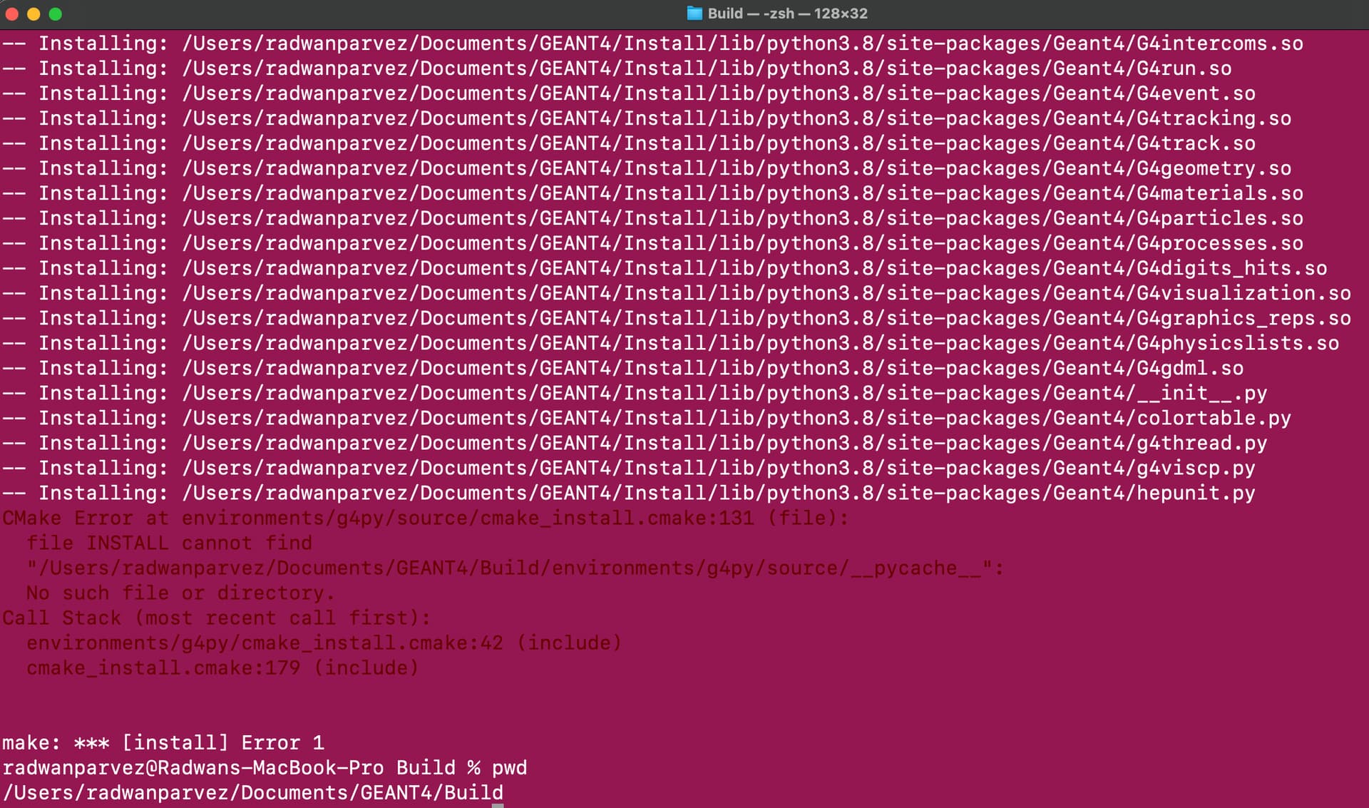

The terminal took approximately 30 minites. But as I run
$ make install
a new error appears
“make: *** [install] Error 1”
(see the attached image)
