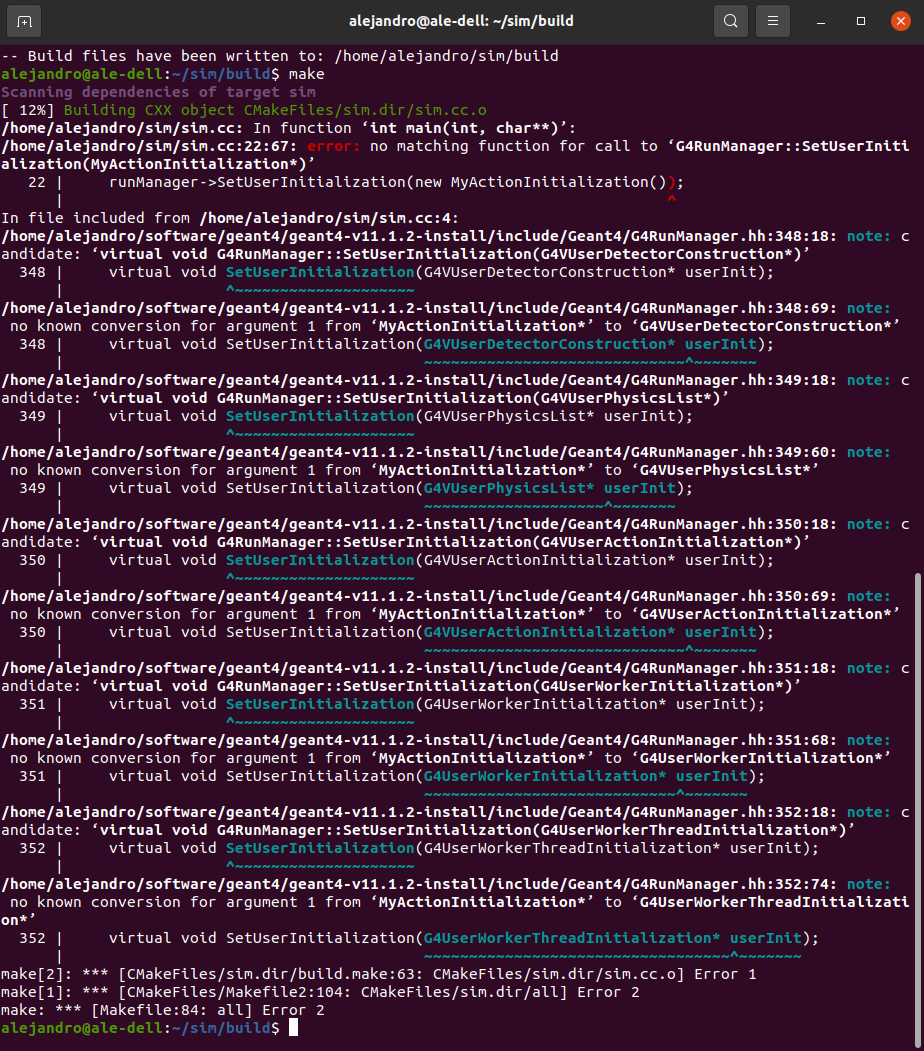

Hello.
I’m having trouble creating the root file.
I changed “g4root.hh” to “G4AnalysisManager.hh” and still I get this error.
please i’m stuck on this
_Geant4 Version: Geant4 11
_Operating System: Ubuntu 20.04
-Alejandro

The error message complains about MyActioInitialization
class; do you have #include "MyActionInitialization.hh"
in your sim.cc ? Does your MyActioInitialization
class derive from G4VUserActionInitialization
Hello and thank you!!
I added #include “My Action Initialization.hh” in my sim.cc and it shows me an error about not finding the file.
This is my file where I declare MyActionInitialization:
action.hh (292 Bytes)
Hi !
Wrong call,
“action.hh” is your MyActionInitialization, therefore, you need to call action.hh i.e. #include action.hh in your sim.cc or main.cc
hope it works for you.
