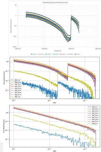

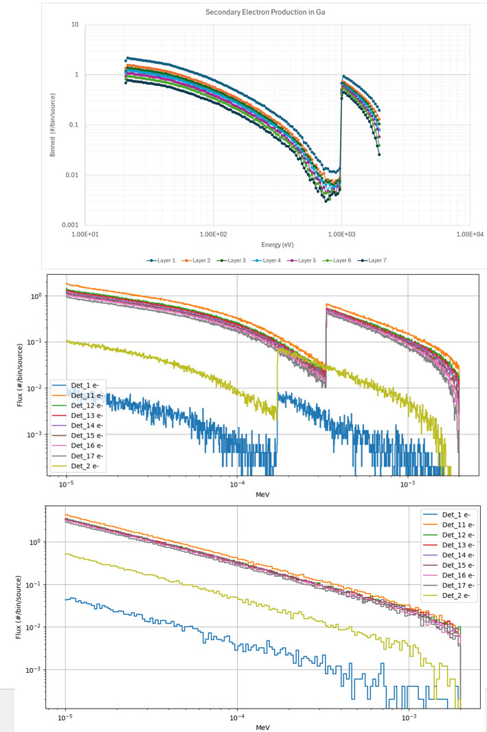

Hi Luciano and Lex,
Thank you for this discussion, I’m actually running into the exact same problem except for a completely different application. I’ll summarize my findings and I’d like some advice on what are the correct settings to use.
Initially my simulations were showing the 1 keV cut-off for secondaries generated by alphas mentioned by Luciano (lowestKinEnergy * massRate). This was causing a sharp drop-off at 1 keV in the secondary electron spectrum (top plot)
After digging into the source code, I found the lowestKinEnergy parameter and modified it to 2.5 eV just to see what would happen. Instead of the spectrum smoothly going down to 10 eV, I actually saw that the drop-off happened at around ~300 eV (for Gallium) and about 130 eV (for Silicon). I believe there is a second limit at around the mean excitation energy (middle plot).
To remove this lower energy limit, I modified the xmin parameter in SampleSecondaries to allow it to generate down to 10 eV, which produces the following plot (bottom plot).
Sorry, I’ve stacked all the plots into one screenshot.
However, what I think I’m essentially doing is just changing the sampling function range down to 10 eV which is just redistributing the secondary electrons to lower energy. The total number of secondaries stays roughly the same (which I’m not sure if this is physically correct or not). The xmin parameter also exists in ComputeCrossSectionPerElectron and ComputeDEDXPerVolume (as the cutEnergy parameter), however, I’m hesitant to modify those since it looks like it changes the actual energy loss and cross-sections. Any advice or comments would be appreciated!
Thanks,
Brian
Hi @bxyzhu
thanks a lot for the follow-up. Indeed, I believe that the xmin should be changed consistently in ComputeCrossSectionPerElectron and ComputeDEDXPerVolume, otherwise there is going to be a double-counting (or an underestimate) of the total energy loss. If you shift secondaries to lower energy, I expect (physically) that there should be more of them produced. I guess that in the current case you are just changing the sampling function of secondaries, but without affecting the restricted cross section (and this the reason why you get approximately the same number of secondaries, with a globally lower energy loss).
Ciao, thanks for the discussion
