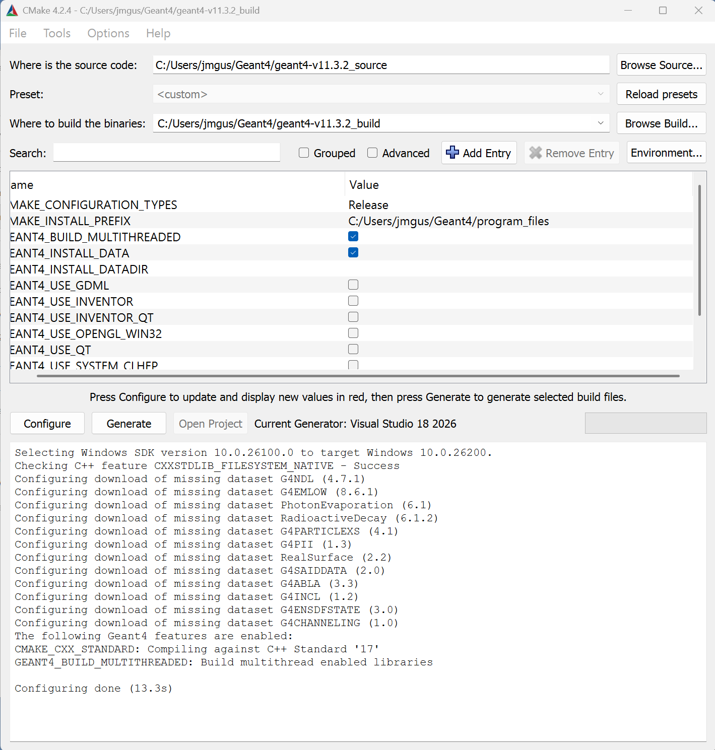

I am attempting to install Geant4 11.3.2. However, I am unable to finishing the build in Visual Studio 2026 due to error
-LNK1189 - library limit of 65535 objects exceeded** (For project G4processes).**
It is then unable to continue the build due to the missing .lib files. The subsequent errors are
-LNK1181 - cannot open input file ‘..\BuildProducts\Release\lib\G4processes.lib’
The same LNK1181 error continues for a variety of libraries.
I have included a screenshot of the CMake settings. As I am a new user, I am only allowed to include one media post but can provide additional information that may be useful.
Any help would be greatly appreciated, thank you.
Jon
