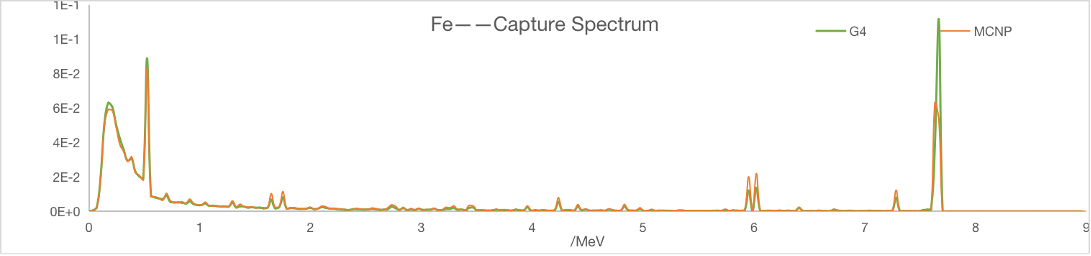

The issue is that Geant4 is giving me the following spectrum,
First, I have not find the characteristic peaks(3.73MeV、3.9MeV) of Ti on the Inelastic Gammas spectrum. And the MCNP6 have got that peaks.
Second, The relative strength of the characteristic peaks(7.63118MeV(100%)、7.64558MeV(86%)) of Fe on the Capture Gammas spectrum is not right that is Failing to Match with MCNP6.
