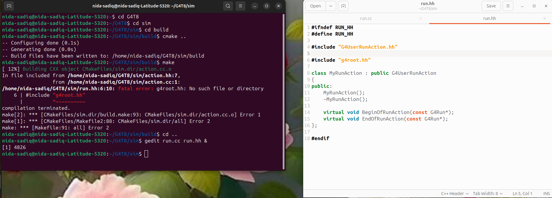

The first screen shot shows it cannot find g4root.hh. Why did you include it? It does not seem necessary. Simply remove it.
Given that the above error caused compilation to terminate (as it says), how did you get an executable that is shown in the other screen shots?

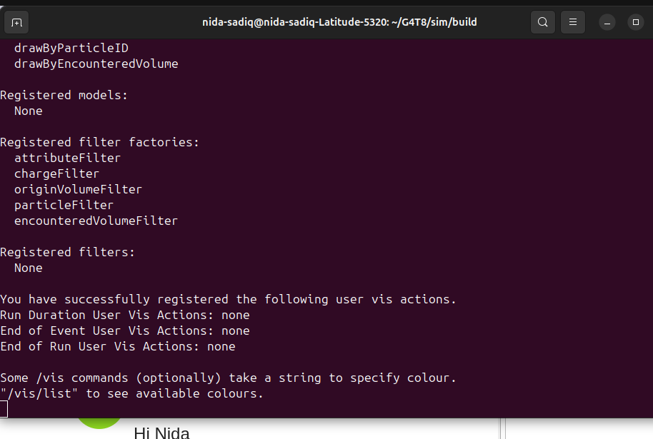

Hello Nida, I had similar issues following the same tutorial. What worked for me was to pass
XDG_SESSION_TYPE=x11
before running the executable. Additionally, g4root.hh isn’t present for geant4 installations past 10. You will have to use G4AnalysisManager.hh
