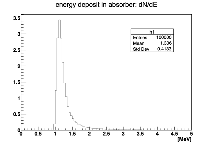

Example TestEm5 is well adapted for this kind of exercice.
Below, a macro for TestEm5, an extract of its printout, and the plot.
To compare with PDG values, do a run with fluctuations = false.
hezin.mac.txt (560 Bytes)
hezin.out.txt (764 Bytes)
