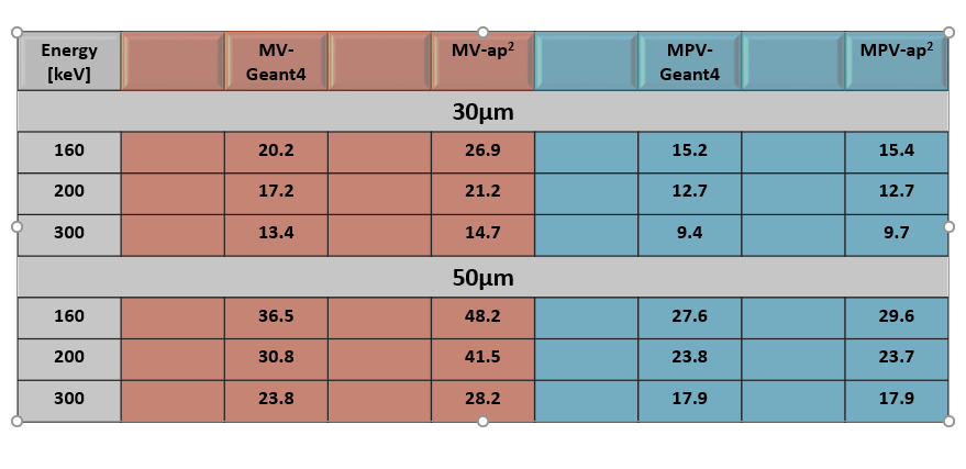

I visited the Geant4 beginners course until recently. Now I am trying to implement everything into practice. I was running simulations on both a 30µm and a 50 µm silicon sensor with TEM electron energies of 160, 200 and 300 keV. The physical model I was using was FTFP_BERT_EMZ and I was usingbins of 0.1 keV intervals and 10 mio events. My colleage was running the same analysis using allpix squared using the same parameters. Nevertheless we significantly deviate especially the mean value at low energies (160 keV). The other value is the most probable value.
Does somebody know the correct values please?

Thank you very much for this hint: we took different production cuts
Hi Luciano, after your advice and also corrections in the geometry (which also differed) we became now very close together. Nevertheless we still see some (small) deviations.
