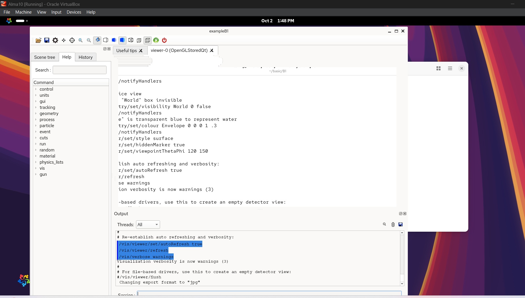

i have just installed geant4 on alma linux 10. as i executed expample B1 it shows some geometry rendering issue, not any error specifically just background desktop or windows are apearing instead of the geometry.
as i changed the vis driver to OGLIX or OGLSX then there is proper visualization of geometry but outside Qt gui in a separate window.
can anyone help what could be the problem and why OGL is not rendering the geometry properly.
