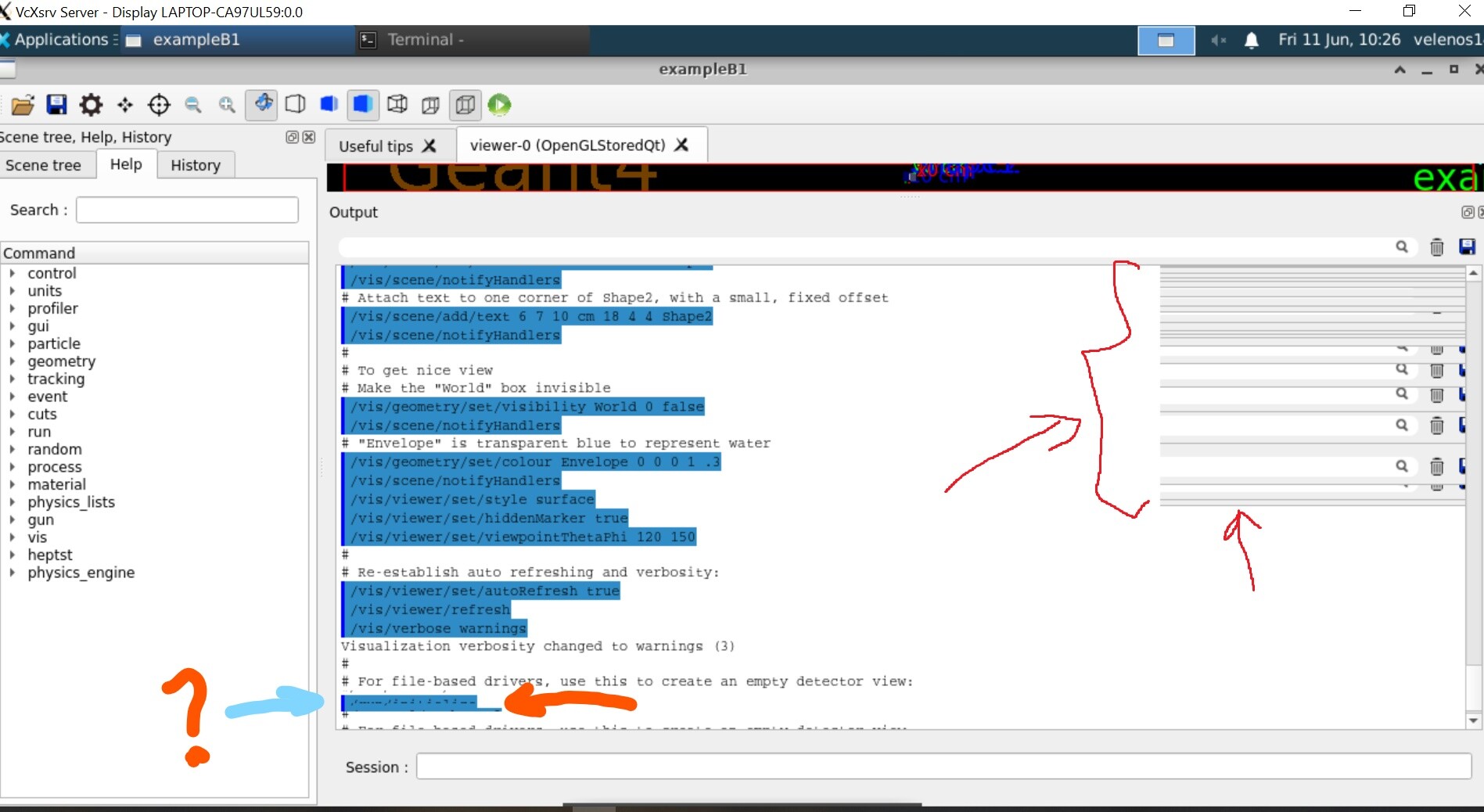

I have a Win10 laptop with a Windows Subsytem for Linux WSL1 installation.
I have compiled Geant4 with visualization drivers.
I can compile examples and run them.
I am running the compiled executable from a window manager xfce4 terminal which opens a ‘‘linux world’’ inside a VcXsrv.
It opens alright (for example B1) but I get graphical streaks when scrolling through the interactive command line, or when playing with the Left-Hand side menu (whenever I expand the options and then collapse them). This gets annoying and hinders visualization of the output messages. Say I write in the command prompt of Geant4: /set/smth/to/0MeV/or/so and then press enter, Geant4 produces warnings or other messages. If I scroll a little bit up to visualize the start of the output, whenever I scroll down there’s some sort of a memory of what was on the screen at earlier times and I cannot visualize more of the output anymore… I don’t know how clear is this but I attach some pictures.

I specify that inside the terminal of xfce4 session, the commands appear smoothly on the screen and I scan scroll up and down, so I believe my problem is due to G4.
Please can you help me solve this? I haven’t found anything online related to this and SO and Ubuntu forums seem not to know how to answer my q.
