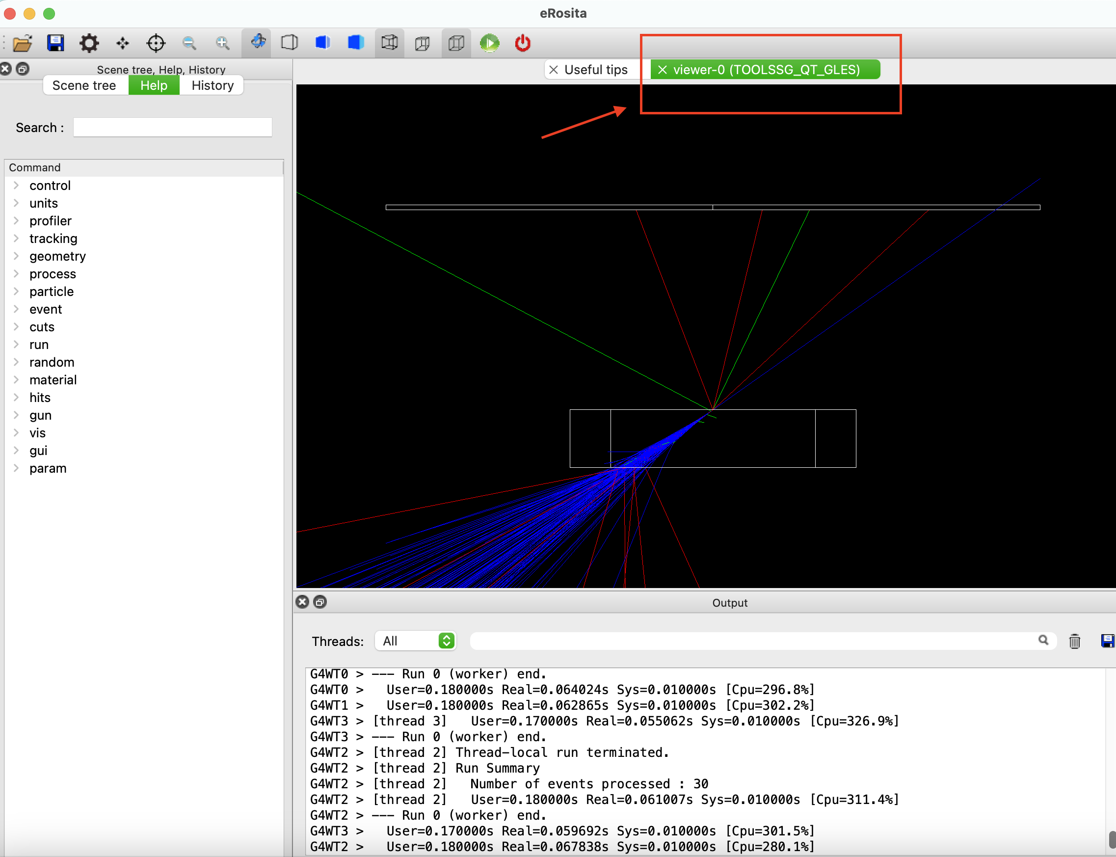

Hi jamesv,
Running this example in batch mode seems OK,here is what the terminal shows after I run ./eRosita eRosita.in

--> G4TaskRunManager::CreateAndStartWorkers() --> Initializing workers...
/gun/energy 100 MeV
/gun/particle proton
/run/verbose 2
/tracking/verbose 0
/run/beamOn 1000
