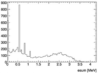

Yes, I want to record the total energy deposition for an event.
Here, a printout of example rdecay01 which shows why the total energy deposit can exceed 2.6 MeV
dmleo.mac.txt (250 Bytes)
dmleo.out.txt (12.2 KB)
Tl208 decay scheme (source) goes to multiple excited states of Pb208, with small but non-negative probabilities of gamma cascades. These will pass your filters.
