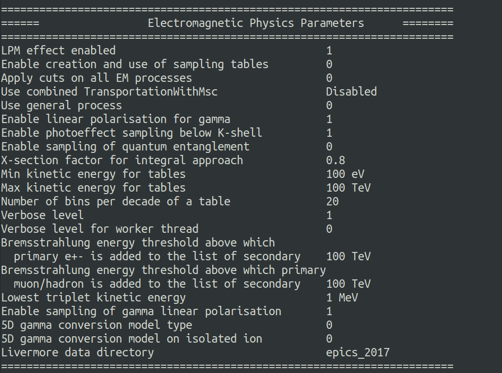

I am modeling positron annihilation using Na22 as my primary particle. I am trying to enable sampling of entanglement but it is showing ‘OFF’. Is there a way to do it in the PhysicsList.cc. I am using the following main physics lists
G4EmLivermorePolarizedPhysics.hh
G4LivermorePolarizedComptonModel.hh
G4eplusAnnihilation.hh
G4RadioactiveDecayPhysics.hh
However, when I run my simulation, I get the following output for EM parameters,

/process/em/QuantumEntanglement true
Note that entangle is only implemented in G4EmLivermorePolarizedPhysics, so where you instantiate your physics list:
  physList->ReplacePhysics(new G4EmLivermorePolarizedPhysics);
You may also need to allow for acollinearity, e.g:
  G4Material* water_mat = nist->FindOrBuildMaterial("G4_WATER");
  water_mat->GetIonisation()->SetMeanEnergyPerIonPair(5*eV);
This gives the positronium a small thermal motion, so the gammas in 2-gamma annihilation are not quite back-to-back. See comments in source/processes//electromagnetic/standard/src/G4eeToTwoGammaModel.cc:
