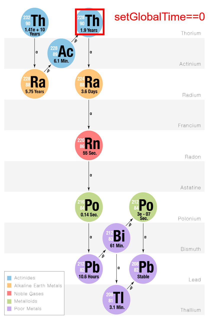

I would like to know if the time obtained from GetGlobalTime has a specific limit on the number of significant digits, because I found that when I set SetGlobalTime(0) for secondary particles with parentId == 2, many of the subsequent recorded times are identical. It seems like the precision is not sufficient.
  • Row * Instance * eventId * trackId * type * time * td *
  •    0 *        2 *                         0 *                       145 *                     gamma * 178737765.201425254344940 * 178737765.201425254344940 *
  •    0 *        3 *                         0 *                       145 *                     gamma * 178737765.201425254344940 * 178737765.201425254344940 *
  •    0 *        4 *                         0 *                       168 *                        e- * 178737765.201425254344940 * 178737765.201425254344940 *
The Thorium decay chain is very complex, it is entirely possible that those entries correspond to the same decay event with subsequent x-ray emission being emitted nearly instantaneously. It would depend on the actual states and the entries in Geant4’s tables. Also when are you recording these times?
The 6th significant digit in the timestamp corresponds to femtoseconds which is on the order of the time it takes light to move across a nucleus. You do not need higher precision.
I record the time when an energyHit occurs, and the unit of time here is seconds (s).
If you’re looking at secondary or tertiary tracks, you should be recording both global time and local time. That will let you deal with the dynamic range (not precision).
