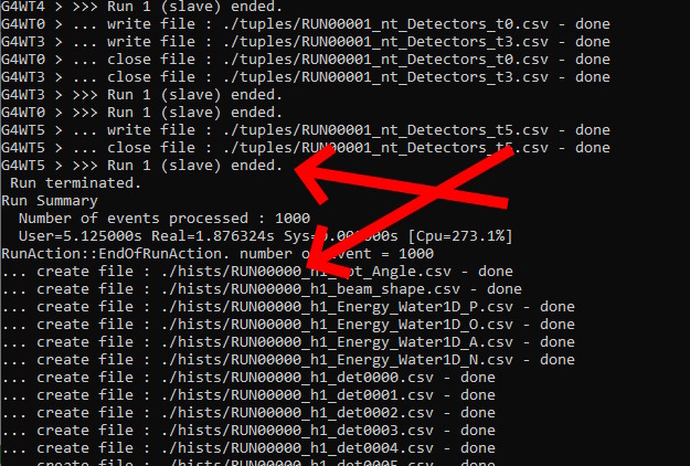

I have found the reason of my troubles.
This code works correctly:
int main(int argc,char** argv)
  auto* runManager = G4RunManagerFactory::CreateRunManager();
but in my application I used another constructor:
  auto* runManager = G4RunManagerFactory::CreateRunManager(G4RunManagerType::MT);
and it was a reason my troubles.

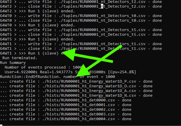

just for illustration how it looks: green arrows correct behavior, the red ones - incorrect
