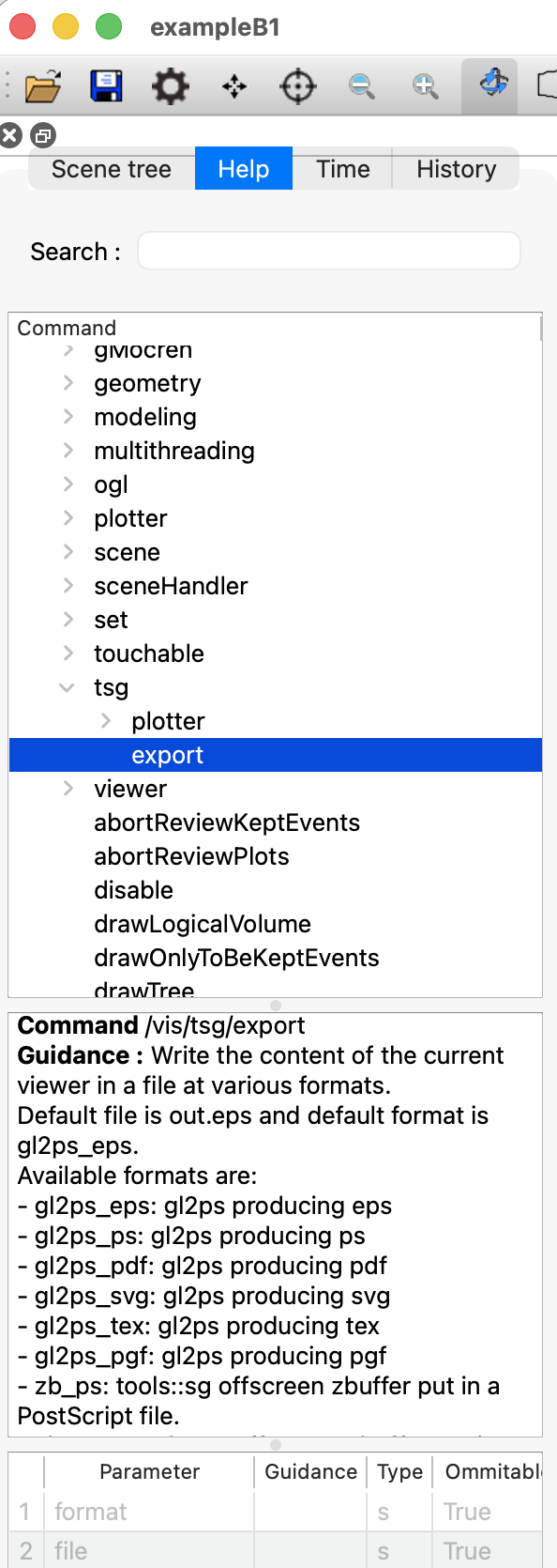

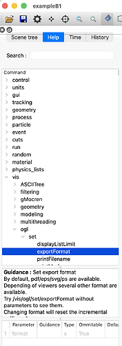

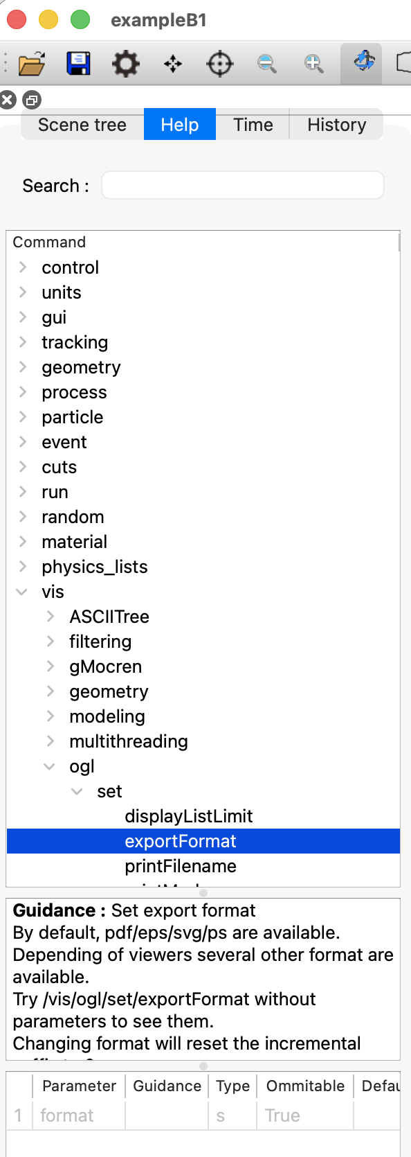

Yes there is a format command. (To find commands, use the Help tab, or type “ls”.) See attached images.
Similarly, the TOOLSSG viewer (which is the default nowadays).
