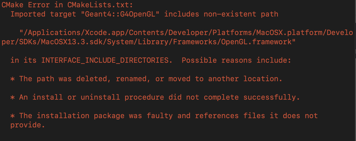

Imported target "Geant4::G4OpenGL" includes non-existent path
Geant4 Version: 11.0.2
Operating System: MacOs
Compiler/Version: Xcode
CMake Version: 3.27.5
Hello, I tried to run a project and thois error showed up. :
Which version of macOS is this, and have you upgraded this since you built/installed Geant4 (or the Xcode version)? I suspect that this is the Geant4PackageCache.cmake file keeping a now uninstalled path. You could try deleting that file and seeing if that helps - it’s not critical to the functionality.
macOS : Ventura 13.5.2, and no i didn’t upgrade it
I’d still suspect this is due to Xcode having updated with the Geant4 install having been done with the previous version. So the solution is:
  1. Confirm that /Applications/Xcode.app/Contents/Developer/Platforms/MacOSX.platform/Developer/SDKs does not contain a MacOSX13.3.sdk subdirectory (I’m guessing there will be MacOSX13.5.sdk).
  2. Locate the file Geant4PackageCache.txt in your Geant4 install area and delete it.
Step 2 should fix the issue.
Yes, that was the issue
/Applications/Xcode.app/Contents/Developer/Platforms/MacOSX.platform/Developer/SDKs does not contain a MacOSX13.3.sdk, I just changed to MacOSX14.2.sdk
Thank you
