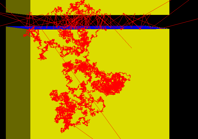

I was trying to model in Geant4 electron interaction with the walls of 2 thin layers of different materials. The energy range of electrons is between 0 eV and 210 eV. That conducted me to see build the elastic model based on ELSEPA data (as a discrete process) and the inelastic model (as a continuous discrete process) by computing cross sections using Gzysinski model.
Do you think this approach is right ? The problem I have is that I see too many interactions in the bulk and not just around the surface, and this is not in agreement with my expectations. The bulk material in yellow in this screenshot has a depth of 10 cm and the thin layer in blue is just 10 nm.
Thank you very much for your insight.
