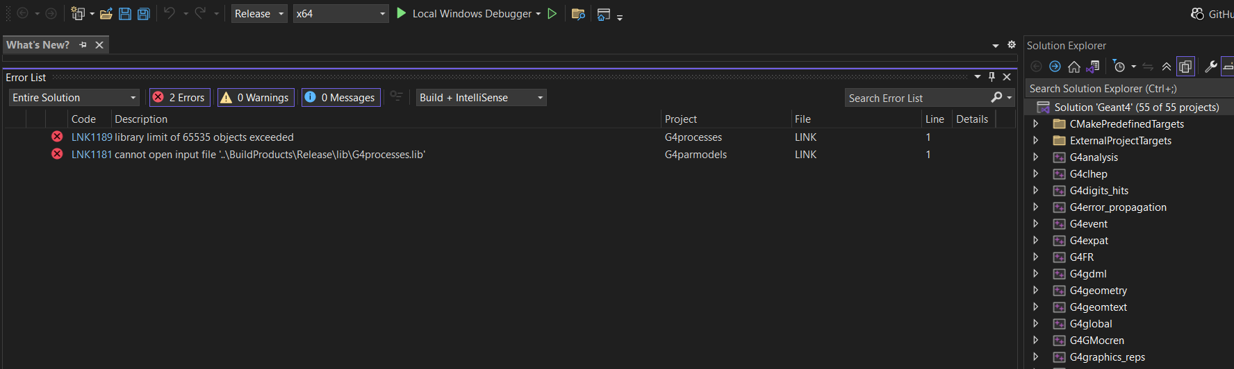

LNK1189 error despite running in release and using shared libraries in CMake
_Geant4 Version:11.3.2
_Operating System: Windows 11 24H2
_Compiler/Version:VS 2022 17.14.8
_CMake Version:4.1.0 rc2
I have already tried the suggestions in previous threads and I keep on getting the LNK1189 and consequent LNK1181 errors. There were no problems in configuring and generating in CMake

Hi John,
I have attached the screenshots from CMake and the build errors in VS. I don’t understand what you mean with the example as I have not completed the installation itself.

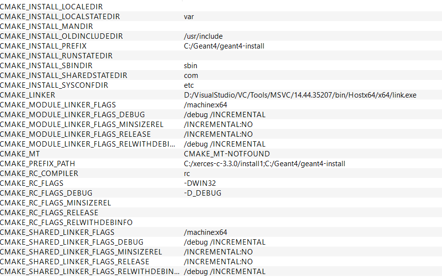

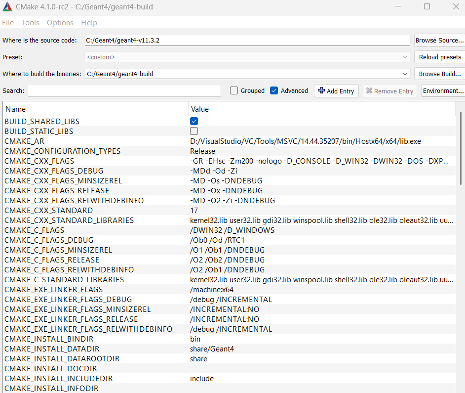

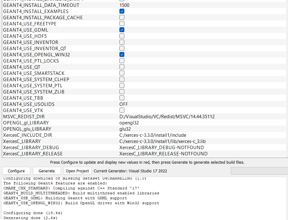

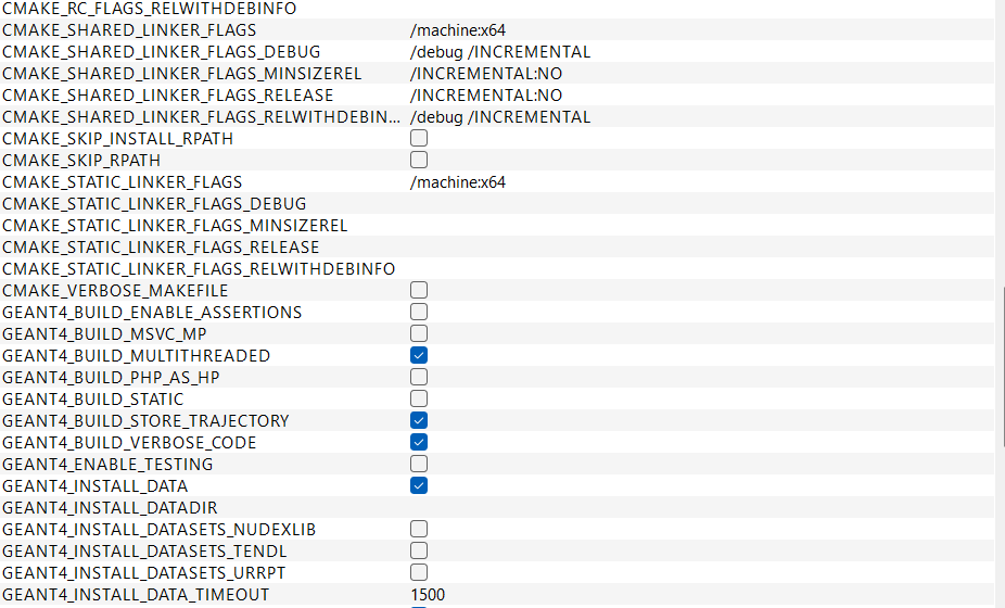

I can’t spot anything obvious in the configuration that would cause problems here, except for the presence of the GEANT4_BUILD_STATIC option in the Name column. That’s not a variable that the Geant4 scripts set so might be worth trying to determine where that comes from if you didn’t set it manually.
Maybe also toggle the “Advanced” tick box in the CMake GUI and see what the values of the other variables are, in particular the BUILD_SHARED_LIBS and BUILD_STATIC_LIBS options.
The GEANT4_BUILD_STATIC was something suggested to me by ChatGPT for the linker errors
These are my settings under Advanced.
