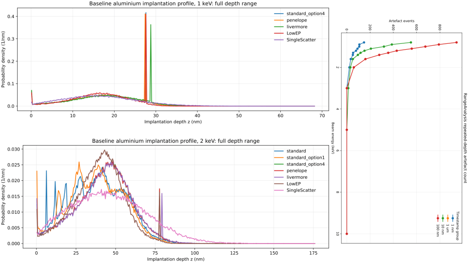

I am currently building an application to run positron implantation simulations. The energy range would be 1-30 keV. Here, the important quantities would be the resulting implantation profile and backscattering rates; positrons would be tracked until termination.
For this, I have looked at the different electromagnetic physics lists provided; however, during preliminary runs, I encountered low-energy artifacts that persisted up to 3 keV in incident beam energy. These appear when the Goudsmit–Saunderson model is used for multiple Coulomb scattering. I have run some diagnostics, and my results indicate that the artefacts may be related to source-code conditions controlling when multiple scattering is allowed to sample a scattering displacement or direction change. Below is a summary of the artefact and what I have observed.
( Aluminium target, monoenergetic beam 10nm away from the target)
  • All artefact events are two-step events. The first step transports the primary positron from its creation position to the target boundary, and the second and final step occurs inside the material.
  • In all artefact events, eIoni is the process defining the final step.
  • In all artefact events, the ratio finalStepLength/restrictedRange is exactly 1.
  • All artefact events have exactly the same implantation depth and no lateral displacement.
My source code observations:
  • In G4VEnergyLossProcess::AlongStepDoIt(), the stopping branch is entered when the step length reaches or exceeds the remaining range.
  • In this branch, the remaining pre-step kinetic energy is assigned to energy loss, the proposed kinetic energy is set to zero, and the remaining energy is proposed as a local energy deposit.
  • In G4VMultipleScattering::AlongStepDoIt(), SampleScattering() is called only when the true path length is smaller than the remaining range and larger than geomMin. Therefore, multiple-scattering angular and displacement sampling is not performed when the final step reaches the remaining range.
I varied the finalRange, which decreased the number of artefact events by restricting ionisation from depositing all the remaining energy in one step. Here, standard Option 4 was used. I have attached the two model comparisons at 1 keV and 2 keV, as well as the plot showing how the number of artefact events changes when finalRange is varied.
I have the following questions:
  1. Is this expected, or am I doing something wrong?
  2. I am thinking of using the following physics list for my use case: G4eDPWACoulombScatteringModel, Penelope ionisation, bremmsstrahlung, and annihilation. Is this sensible, or should I continue using a multiple-scattering model?
  3. Why doesn’t this artefact appear when using Urban MSC?
I could only add one attachment, so I combined the three graphs into a single image. I apologize if some details are difficult to read.
Thank you so much. I would be grateful for any help or suggestions.

thanks a lot for reporting this, indeed it looks like a model-related artifact. We’ll have to take a look into it, @civanch I think that your proposed physics list (single scattering + Penelope brem/ioni/annih) is very much suitable for your applications.

Hi @Constantin_Luy thanks again for your report and your patience. I have my own reproduced for your observation, to the effect is definitely not related to your specific code. I will try to dig deeper in the near future.

I confirm that the artifact in the range distribution which you observe at very low energy is coming from Geant4 and specifically from the G4GoudsmitSaundersonMscModel. The anomalous population comes from particles which start at the geometry boundary and whose single-scattering interaction length evaluated by the model is longer than the residual path. In this case, Coulomb scattering is completely bypassed: neither single nor multiple Coulomb scattering is applied, leaving the interaction entirely on the ionisation. This produces a peak in the range distribution at the CSDA position from ionization.
As confirmed by the developer @mnovak , this is ultimately due to the fact that the MSC models should not be used below 5 - 10 keV as they provide a largely overestimated elastic mean free path (a factor of 6 at 2 keV).
In this energy range, single-scattering models are appropriate, e.g. G4eDPWACoulombScatteringModel. The suggested combination (as also discussed in the posts above) is single-scattering CS, possibly combined with the Penelope model for ionization.
