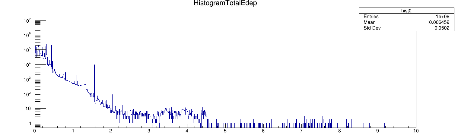

I believe I am spawning in the Am241 correctly, However I found the neutrons to about 1 in1000. I ran a sim where 100000 neutrons were created but zero counted. On the other hand, the gammas were counted but the energies are far to low. Not sure where I am going wrong here since I’ve done this before.
I’m counting all energy deposit in a NaI detector every event. I’m also looking at the energy deposit of the neutrons and gammas to see what’s happening there as well. And also the kinetic energy of particles leaving the world. The code is below and is from Stepping.
So far what I have found is that no neutrons are entering the detectors (Not sure why even though ~100000 neutrons are created)
and
The deposits per event of gammas are small (in the 100’s of eV) compared to their kinetic energy which are in the 100 KeV and MeV.
I’m starting to think it’s the NaI detector I built.
The way I have it set up is that each component (NaI crystal, housing, PMT, ect) of the NaI detector is the daughter of NaIDetector, which itself is a daughter of the logicWorld.
Is this correct or does a boolean subtraction need to take place?
This is the result I get for all energy deposited per event in the NaI detector. Does this look correct?
