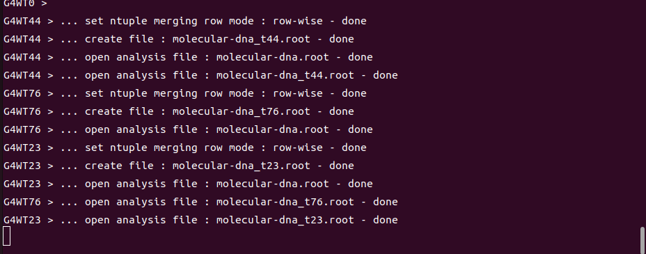

Hi @ctwhite — many thanks for your patient and detailed reply.
As you suspected, our machine is a dual-socket system with two AMD EPYC 7542 CPUs (32 cores / 64 threads each), for a total of 64 cores / 128 threads. That’s why I launched the job with -t 128. (See the attached screenshot.)
Regarding the small number of events: we intentionally used 20 events at 100 MeV C-12 because of memory pressure observed during test runs. With 40 events, the job was killed due to out-of-memory; with 30 events, peak memory reached 95.3%, so we chose 20 as a safer setting.
For context, we have successfully run the molecularDNA example with other primaries using the same source configuration (except for energy):
  • Electrons: 100,000 events
  • Protons: 400 events
  • Deuterons: 400 events
  • Alpha particles: 50 events
All of these produced DNA damage outputs and histograms, with wall times ranging from tens of minutes to tens of hours.
To give a complete picture of what we’re seeing with C-12, I’m attaching:
  • the full human_cell.mac we used,
  • the terminal output printed during the run, and
  • the top -H process view.
As shown, the molecularDNA run appears to stall at the point indicated in the terminal output and stays there for a long time.
Thanks again for your help, @ctwhite. If you have further suggestions based on these details—e.g., settings specific to C-12 ions in molecularDNA, or any known pitfalls—your guidance would be greatly appreciated.
