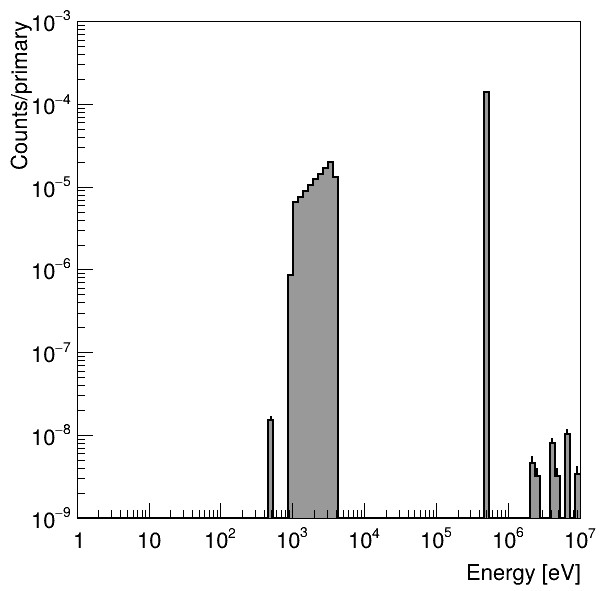

I was checking secondaries produced in 10B(n,a) reactions and I’m seeing some unexpected gammas. From my understanding, if 7Li* is produced, it deexcites with a ~478keV gamma. When I print out the particles produced, I get the following:

Here is the resultant histogram and as you can see, it ends up being a pretty big flux of single keV gammas. When I checked ENSDF, I only saw the 478 level so I’m not sure of the cause. I’m also confused that they always seem to be in pairs of identical energies. I was curious if anyone had an explanation?

Have you tried: /process/had/particle_hp/do_not_adjust_final_state true ?
That seemed to make them disappear, thanks! Is that just an artificial conservation of energy adjustment that geant does?
