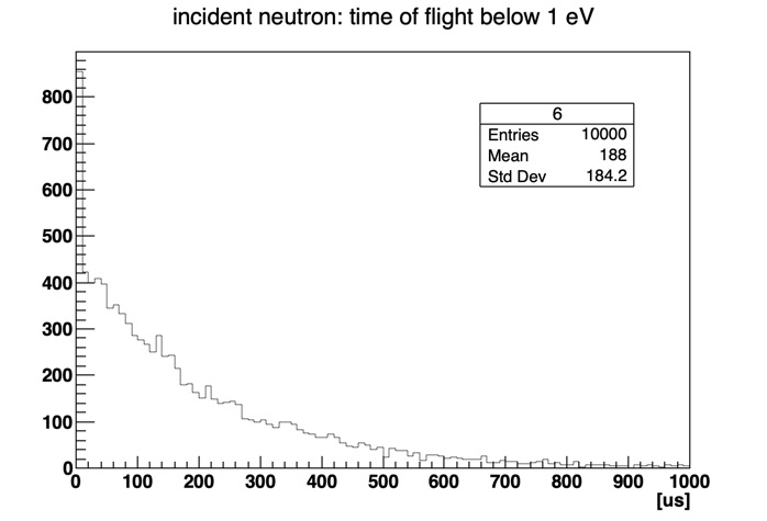

Here a macro for example Hadr04, its printout with Geant4 11.3 and the plot of time of flight.
On the printout you can read that the mean value of time of flight is ~197 us

I tried replacing the hadronPhysics of my simulation and get the correct time distribution.
